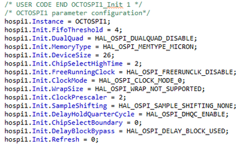

I made some tests based on OSPI_NOR_MemoryMapped example with STM32L552E-EV board.
The Device Size configured in STM32Cube MX indicates the size of the OSPI memory in bytes and expressed in 2^n. The datasheet of the MX25L51245G is 512M-Bit = 64Mbytes = 0x400 0000. We see the bit 26 is set meaning 2^26 = 64 Mbytes. In STM32CubeMx we set the device size field to 26.
How to configure "Device Size" in STM32CubeMX is descripted in How to set up the OSPI peripheral to interface with the IS25LX256 from ISSI and in table Table 7. STM32CubeMX - Configuration of OCTOSPI parameters in AN5050.
The device size configuration is down in the HAL_OSPI_Init function by using this code
/* Configure memory type, device size, chip select high time, delay block bypass,free running clock, clock mode */

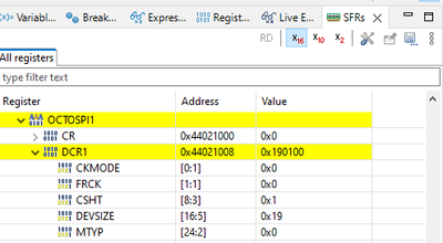

MODIFY_REG(hospi->Instance->DCR1,(OCTOSPI_DCR1_MTYP | OCTOSPI_DCR1_DEVSIZE | OCTOSPI_DCR1_CSHT | OCTOSPI_DCR1_DLYBYP | OCTOSPI_DCR1_FRCK | OCTOSPI_DCR1_CKMODE),
hospi->Init.MemoryType | ((hospi->Init.DeviceSize - 1U) << OCTOSPI_DCR1_DEVSIZE_Pos) |((hospi->Init.ChipSelectHighTime - 1U) << OCTOSPI_DCR1_CSHT_Pos) |hospi->Init.DelayBlockBypass | hospi->Init.ClockMode));
So, the DEVSIZE bits filed in OCTOSPI_DCR1 registers get the Init.DeviceSize (configured in ioc file) - 1U, which is in line with RM0438 description.
For this example: 512 M-bit memory size is represented with the DEVSIZE=25 decimal=0x19 hex, that we see when debugging the project as shown in the below figure.
In conclusion the "Device Size" in STM32cubeMX is DCR1_DEVSIZE+1.
