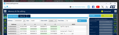

External loader built; CubeProgrammer can erase, program, verify and read the entire flash (see screenshot).
Constant data is programmed successfully:
const char string2[30] __attribute__((section(".ext_flash"))) __attribute__((aligned(4))) = "Hello Word";CubeProgrammer shows the text correctly.

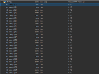

As soon as I switch to Memory‑Mapped mode every word read is 0x00000000.
No hard faults—just empty data.

Also tried with caches fully disabled → still 0x00.

With STM32CubeProgrammer and the external loader I could read the data:
