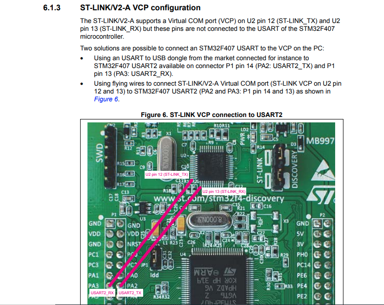

I have the STM32F407G-DISC1. It is true, if it didn't have that functionality it wouldn't be possible to reconfigure it. I checked the user manual and the embedded st link supports a Virtual Com Port, but as the manual said these pins are not connected. I attach a part of the manual that says itMy real problem is when I search the Virtual Com port in my Pc.

You are probably using older version of that discovery kit. It's written in the UM that only the current one supports the VCP.
2021-06-17 2:32 AM
@FArle.1 , here is the footnote about the board version difference. The exact order code to tell the boards apart should be in the blister insert.
J.
