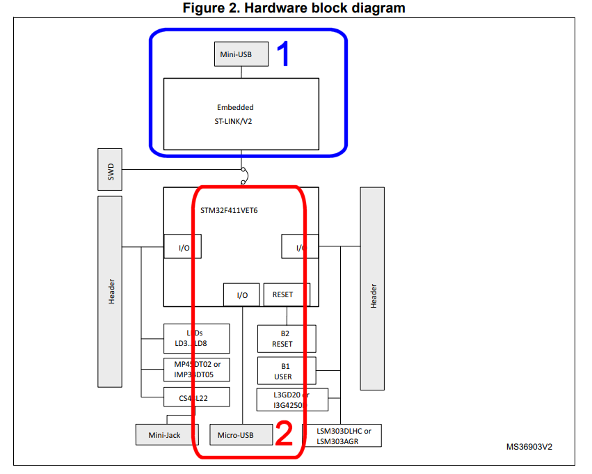

Which "device" are you referring to?
There are two on this board:

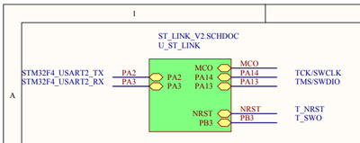

Although the schematic does show UART connections to the ST-Link:
https://www.st.com/en/evaluation-tools/32f411ediscovery.html#cad-resources

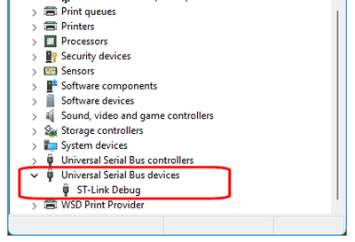

@gammmmmm does the ST-Link show as a debugger in your Device Manager?
See: https://community.st.com/t5/stm32-mcus/how-to-solve-debugger-connection-issues/tac-p/698105/highlight/true#M956 for troubleshooting tips

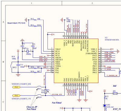

The Original STM32F4-DISCO lacked mbed and the VCP/MSC, smaller STM32F103
Later mbed was adopted, and a newer/larger STM32F103 was employed
The STM32F4-DISC1 iteration escaped the ST-LINK/V2-1 VCP to pins, but did not change the circuit to get them to the STM32F407
The NUCLEO-F4 boards DON'T have this issue because they came out to support mbed.
But the NUCLEO-64 boards typically shared the VCP UART and ARDUINO D0/D1 pins

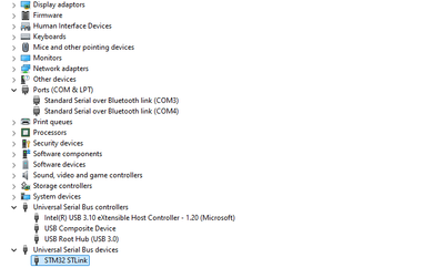

Hey, it appears as STM32 STlink
