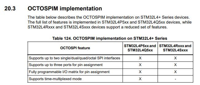

The multiplexed mode is not supported for STM32L4R/Sxxx series.
You can check the "Table 124. OCTOSPIM implementation on STM32L4+ Series", in the STM32L4+ Reference Manual (RM0432) described that the multiplexed mode is not supported for STM32L4R/Sxxx.

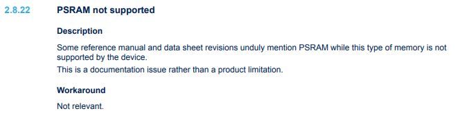

Note that the OCTOSPI-PSRAM memories (including HyperRAMs) are not supported in the STM32L4R/Sxxx products.
0693W00000Bbof2QAB.jpgFor more details, please have a look at the STM32L4Rxxx / STM32L4Sxxx errata sheet.
So, It's recommended to use Parallel PSRAM memories with FMC or to switch, if possible, to a STM32L4P5/Q5xx product which supports OCTOSPI PSRAM memories.
