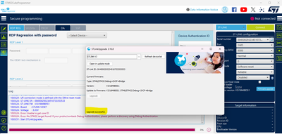

Using the STMCubeProgrammer tool, did you try to upgrade the ST-LINK firmware version?
2025-08-12 1:08 AM
Yes i tried both variant's.

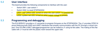

Did you switch on the DC power supply input?
Did you review the evlservo1 um3375 user manual document?
2025-08-12 2:10 AM
Hello, Yes the DC Power is on and the 3,3 Volt are recognized by the V3 debugger and LED 1 and LED 2 are showing the supply voltage as described in the Manual.
Regarding the flash proses i do not find to many hints in the Manual.
