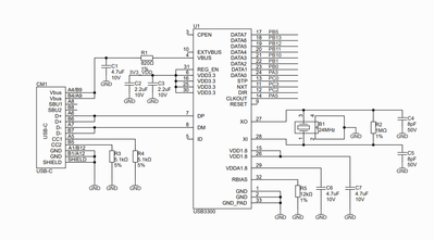

I've been working for a little on this and can't wrap my head around what the issue is, so figured I'd post here. As a start I'm doing a graduation project from a computer science education and am working on a project that requires a high speed usb to be implemented on a nucleo h755ziq. There are other pieces in play, but those have been disconnected to try and get this one part to work. To make this work I have the nucleo board and a usb3300. This usb3300 has been put on a board and connects to pins placed on the nucleo. I have quadrouple checked the pins and they are all correct.

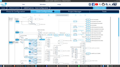

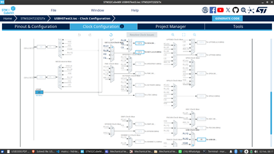

I have set up the clock for the stm to 192MHZ due to the other components that will be added later, and the pll2 is set to 24MHZ for the usb as shown below.

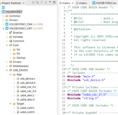

From here I build the project without errors. The middleware shows up and usbd_cdc_if.h added to the main c file as shown here.

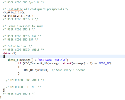

Last I initialise it and attempt a Transmit.

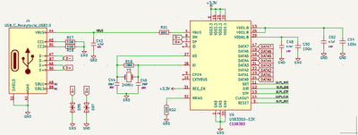

lastly the specific usb3300 im using it's datasheet can be found in the attached file and the setup for the usb (how I was given the usb) is shown below in the picture.

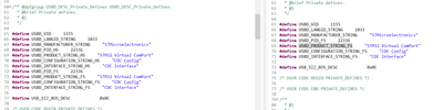

For those interested, the solution has been found!
It appears the device descriptor in usbd_desc.c wasn't generated properly. Because of this, the HS usb device couldn't be recognised. I found this out by connecting both the HS and FS usb (FS being the one that comes with the board). The FS connected without problems but HS did not. After setting up a new project and holding them side by side, I imediately saw the difference this morning and tada, it shows up finally and I can continue working on this project!

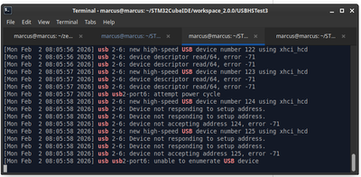

2026-02-01 9:27 PM
Hi @Igneous I looked at your schematic design and compared it with what I have, they look almost the same. The difference is that I am using STM32H723ZGT6.
I found the issue being device descriptor.
I have repeated the configuration process several times (just like yours with the only difference being the chip and clock 25MHz) in STM32CUBEMX, I still find the same problem.
I wonder is some might be able to help me here. So I will attach the .ioc file here. Thanks.
