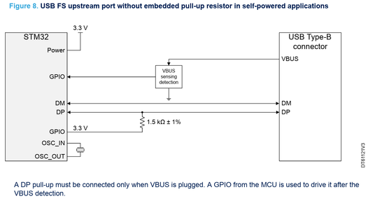

I have a problem with communication between my PC and MCU. I have connected my project according to this diagram (with external 12MHz oscillator):
I attempted to connecting the 1,5k GPIO pin (PA10) to control the pull up. Then I connected a 1,5K resistore to 3V3.
Additionally, I experimented with connecting the VBUS with resistor devider (33k and 82k) to the PA9 and then I tried to connecting VBUS directly to PA9.

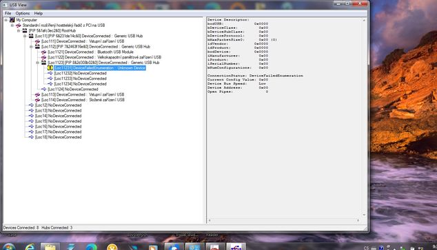

Furthermore, I installing the STM32 Virtual COM Port Driver on win7 32bit and win10 (win8 64bit). Both have the same result:
Same result: DeviceFailedEnumeration : Unknown Device.
Do you have any idea why this enumeration issue is occurring?

Hardware USB analyzer is your friend. It will show what the host sends and how the STM32 responds. Trace messages in the STM32 device firmware can be helpful too.
