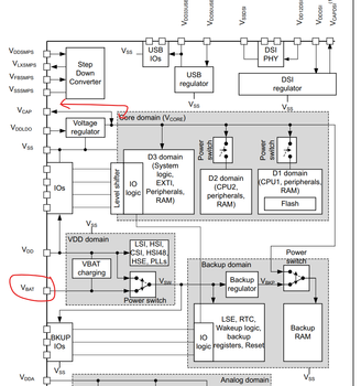

I am using an STM32H755XIH6 MCU in a custom design. I want to use only LDO supply configuration for the internal power regulator that provides the VCORE and I don't really intend to use the SMPS configuration. My schematic has some hardware mistakes, just want to understand their impact before doing a rev.
1. According to RM0399, Section 7.4 - Figure 22, when using LDO supply, do we still need the cap (mentioned) on the VCAP pin? Is it recommended or mandatory? Would it cause major issues if its left floating for example?
1.1. Follow up question on this, is if we plan to use LDO only, does the VDDSMPS and VFBSMPS pin state matter? I have mistakenly left VFBSMPS floating and it's impossible to access it without revving the board.
2. If we don't plan to use VBAT (backup battery), it is given in RM0399, Section 7.4 that VBAT must be connected to VDD if battery is not used and needs a 100nF ceramic decoupling cap on VBAT pin (mentioned in RM0399 Section 7.4.4). But I have it floating, just wanted to understand the issues this may cause for example when we remove power abruptly.

Caps on VCAP are required. It may show activity but will not function correctly without them, especially at high frequencies or extreme temperatures. This one is firmly in the mandatory camp.
VBAT needs to be powered as some of the onboard peripherals are powered from this. Also mandatory.

According to RM0399, Section 7.4 - Power supplies, for VDDSMPS pin the below line is mentioned
it says VDDSMPS shall be connected to GND if not used

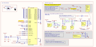

However, in the schematics of Nucleo H755ZIQ schematic rev D, it says VDD_SMPS_IN net should not be connected to GND (DNF)?
Also, it's a bit confusing that some nets are really not present, for example in supply config 1: LDO only, it says disconnect 3V3_SMPS_IN from 3V3_MCU, there seems to be no net named 3V3_SMPS_IN, is that the same as VDD_SMPS_IN? if yes, that DNF doesn't make sense, and there are several more nets like that.
The system supply configurations in RM0399, Section 7.4 - Figure 22 show that VDDSMPS, VFBSMPS and VSSSMPS shall be grounded when not using SMPS and VLXSMPS will be left floating. Should we follow this?
