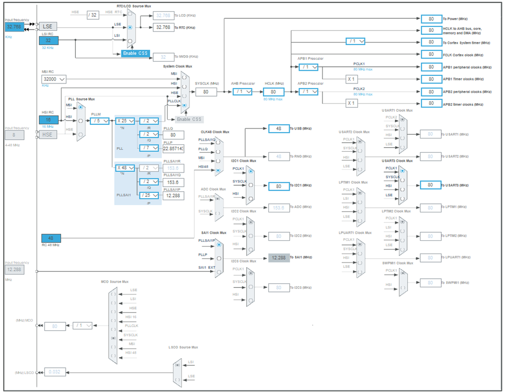

I am using I2S (SAI) on the STM32L433 nucleo board and using the internal MSI RC as the clock source.
I also have a 32.768kHz LSE external crystral which I believe helps to make the MSI RC clock more accurate when used with PLL.
Is the internal MSI RC clock suitable for I2S, or do I need to use an external crystal HSE (12.288MHz) ?
I do get occasional glitches/clicking but I am using development boards with jumper wires, even a small amount of movement with these wires cause issues.
The clock configuration is below...
