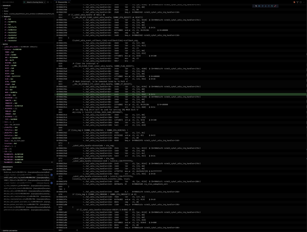

Please refer to following capture of Fault capture, which is explained in detail below:
IMAGE 1 :
IMAGE 2 :
This is a pointer corruption issue caused by corrupted data being read from external flash memory. Let me break down the failure sequence:
The MCU tries to execute following C Code, and triggers fault at executing

}Understanding the execution flow of above code with Disassembly:
ldr r3, [pc, #196] // Load address of _cyhal_sdio_handle
ldr r3, [r3, #0] // Dereference _cyhal_sdio_handle
ldr r3, [r3, #0] // Access _cyhal_sdio_handle->Instance
ldr r2, [r3, #60] // Read Instance->MASK (at offset 60)

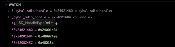

1. Get the address of the global variable _cyhal_sdio_handle:
ldr r3, [pc, #196]
// Equivalent to: &_cyhal_sdio_handle
// R3 = 0x24021480 (address where the handle pointer is stored)
2. Dereference to get the handle value:
ldr r3, [r3, #0]
// Equivalent to: _cyhal_sdio_handle
// R3 = *0x24021480 = 0x24001b04 (the actual sdio handle)

The very first instruction reads from the literal pool in external flash:
ldr r3, [pc, #196] // Reading from 0x900D1A78 in external flash
This literal pool contains the address of _cyhal_sdio_handle (0x24021480), but due to flash corruption, it reads UNKNOWNdata instead which starts the domino effect.
The corrupted address 0xFA7BAFFF points to unmapped/protected memory space, triggering the memory management unit (MMU/MPU) to generate a hard fault when the CPU attempts to access it.
The corrupted pointer value (0xfa7bafff) indicates that data being read from the external flash via XSPI1 is incorrect. This is not a pointer that exists in my code - it's garbage data resulting from communication errors.
Video Showing Corrupted R3 along with Disassembly View Showing Call Stack is HERE
