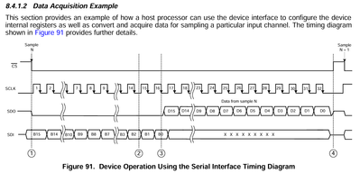

Here's how the data sheet says to read a sample:
You can see it sends 16 bits and reads another 16 bits. You don't do this in your code.
Your ADS_Read_All_Raw function sends and receives 16 bits at a time, not 32, so it never even receives data.
2025-06-18 7:09 AM
Well, but then it should be receiving all zeros, shouldn't it.

Yes.
Looking again, the code does actually send and receive 2 16-bit values as the word size is 16-bit. But since the arrays are sized as 1x uint16_t, there is an out of bounds write happening. It could be clobbering the loop variable.
