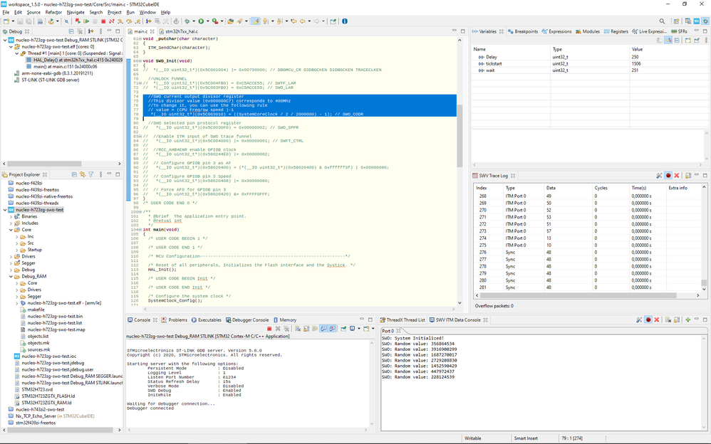

2021-03-09 7:52 AM
Today I used my oszilloscope to measure the frequency of the SWO signal (Resistor on SB32). I followed the guide https://www.keil.com/appnotes/files/apnt_297_v102.pdf on page 4. I discovered that the signal was running at 1MHz not at 2MHz as expected. I seams that the SWO interface runs with half core frequency. I adapted the SWD Init and now it works as expected.
Edit:
The reference manual says:

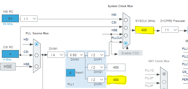

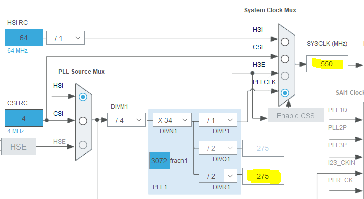

So now I wanted to know where the trace clock is defined in the clock tree.
First I found this on the segger homepage:
https://www.segger.com/products/debug-probes/j-trace/technology/setting-up-trace/
"The trace clock speed (TRACECLK) is on most microcontrollers directly dependent on the CPU clock speed and is usually half of the CPU clock speed."
Then I discovered this in the STM32H723 reference manual page 3088
Then I looked into the clock tree in CubeMX and discovered:
Then I compared the result with the STM32H743 clock tree of my other project:
So now I understand why my code modification is working. Maybe it is better to modify the SWD_Init code to use the DIVR1 value instead of the magic divider 2.
