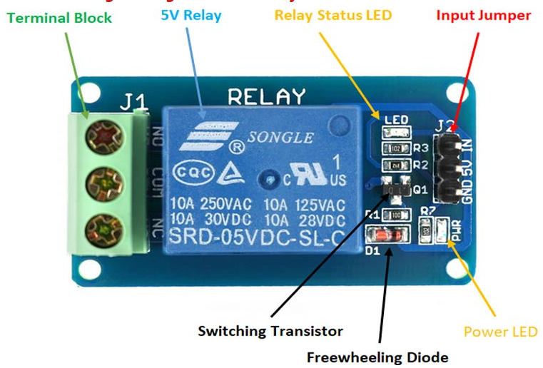

Hy @KnarfB I can give specification details about relay and cartridge if it helps to identify my issue. below are the details
Relay: I am using relay similar to this(https://components101.com/switches/5v-single-channel-relay-module-pinout-features-applications-working-datasheet). And relay board already having freewheel diode. Image attached
Cartridge: Cartridge typical supply voltage is 11v. Image attached
2021-03-16 10:58 PM
Okay, the relay seems haveing its driver included. My other remarks still apply.
