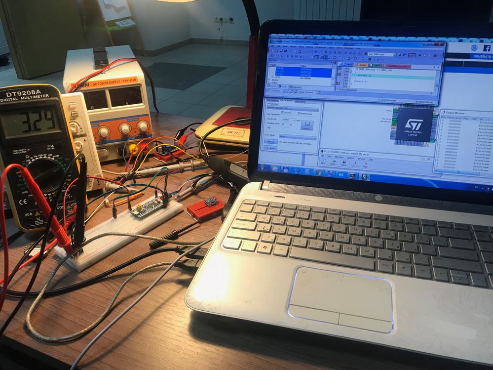

Hello! I can't experiment - I can't receive parcels with a CAN harness and special software. Here is a similar experiment https://www.programmersought.com/article/2185872275/.
I have elements:
1 stm32f103c8t6 board,
2 Debugger st-link v2 (china),
3 SN65HVD230 CAN Bus transceiver,
4 Danfoss CG150 CAN harness.
I have software:
1 STM32CUBEMX 6, FW_F1 V1.8.3
2 Keil 5,
3 Danfoss CAN King (CAN wiretapping software).
Everything is being built and debugged, I have met all the conditions, but I do not see the parcels sent by me in CAN King. Can you help? Thank you in advance! Thank you for understanding.

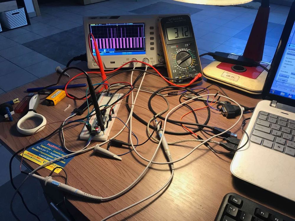

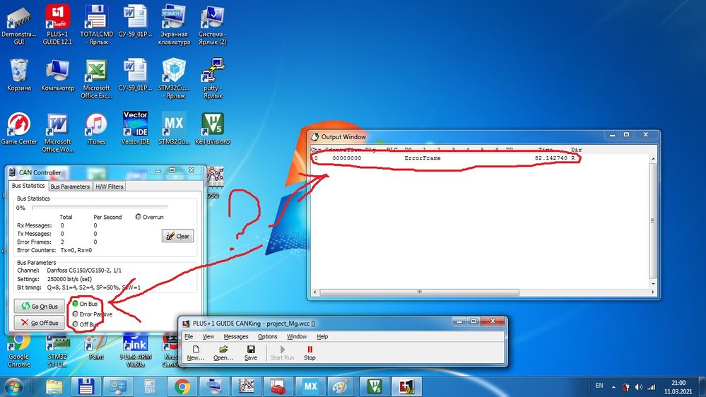

Probably, since the layout of the board is not very good, I see, with the help of an oscilloscope, the sendings to the "CAN" indistinctly extraneous noise climb into the measurements. This noise is approximately 1 mV. In the picture, I circled it in red - it says "ErrorFrame" in the "CAN King" program window - the program reads errors. This is a symptom - this is most likely a synchronization error between the "-stm32" board and the "SN65HVD230" module. How to defeat this error? I set everything up to "baud rate 250k". Maybe there is a method by listening to the registers of the "Stm32f103c8t6" microcontroller to solve such problems? Thank! Thank you for your understanding!

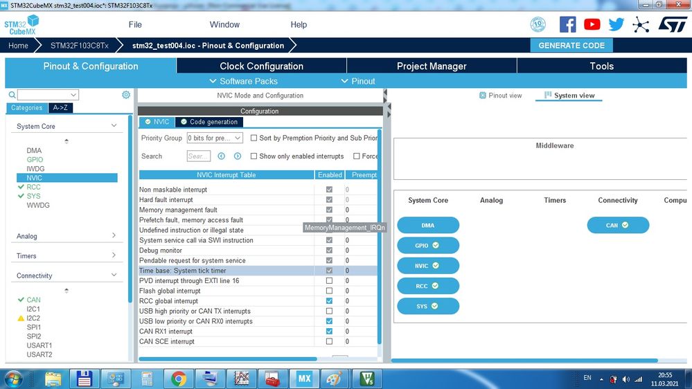

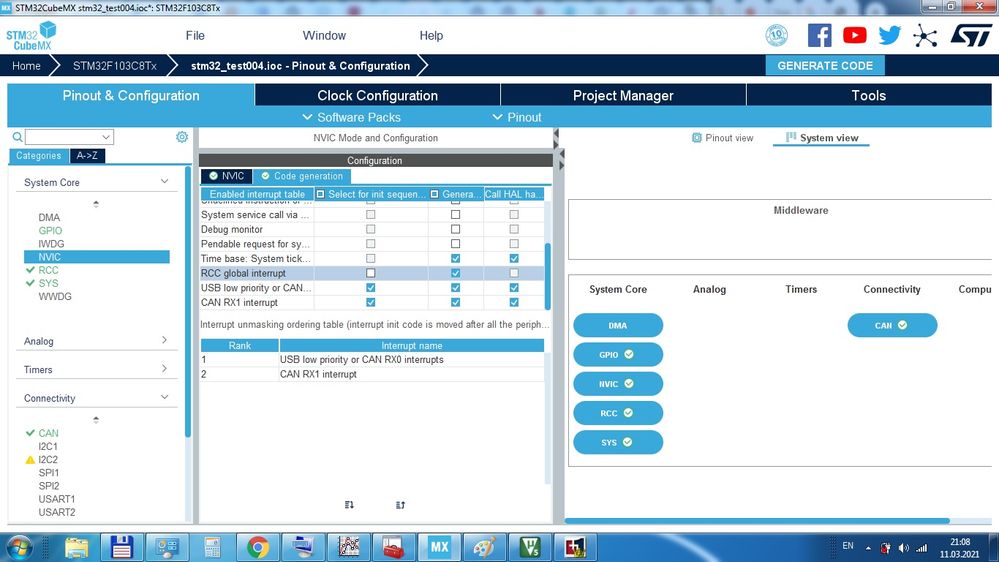

2021-03-11 10:12 AM
Hello! The module "TJA1050" came to me. It did not help, the problem remained. I see in the program "CAN King" - the same "On Bus" and errors. I looked at the "Tx" channel with the oscilloscope - there are not regular sendings, this can be seen from the attached figure: "CAN_Tx_TJA1050". If the sending is not regular, then maybe these are interruptions? Here are my interrupt settings - picture: "interrupt settings". The "Stm32" controller sends non-periodic messages to the "Tx" channel (I have this pin "PA12"). What is it coming from? Thank you in advance for your help!

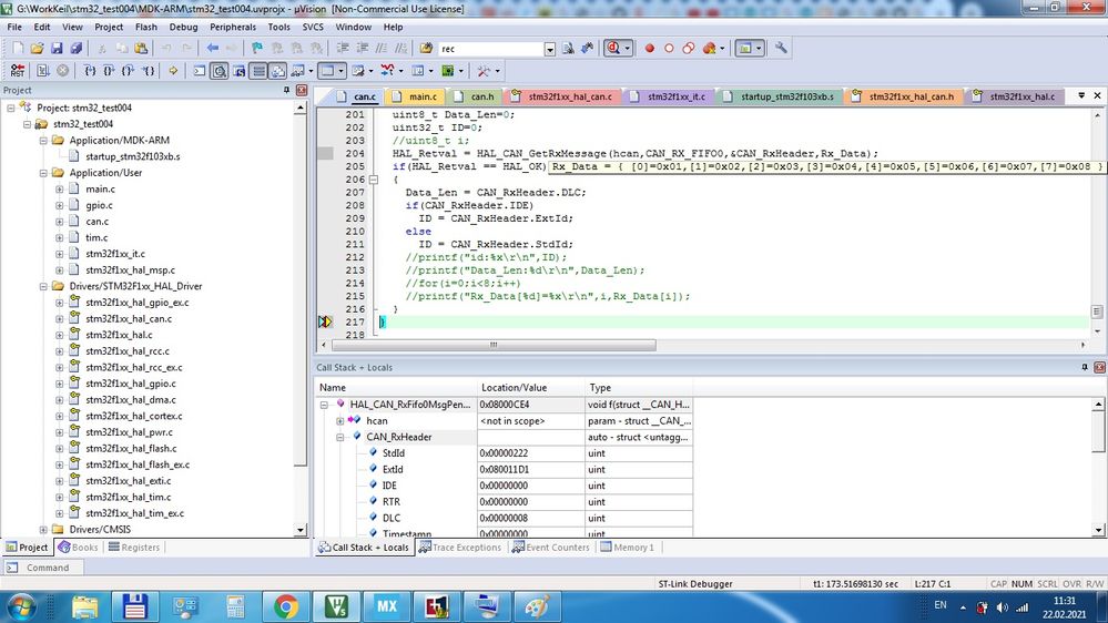

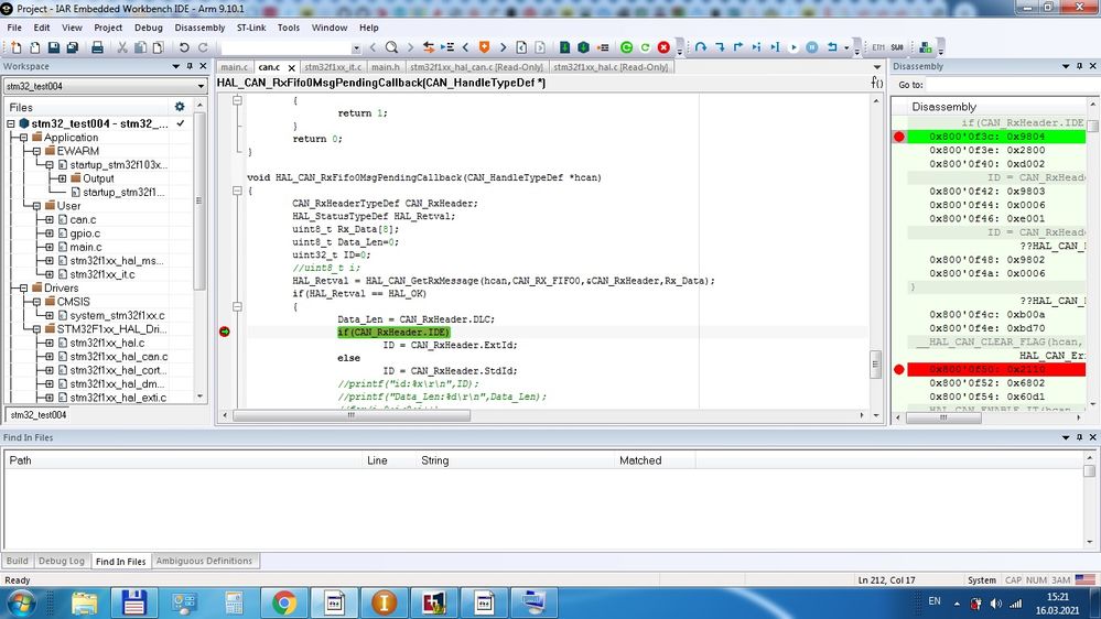

4.CooCox IDE. The problems are the same. The first problem is the non-periodicity of messages when listening by the Tx oscilloscope, both in NORMAL mode and in LOOPBACK mode. The second problem is that there is no HAL_CAN_RxFifo0MsgPendingCallback interrupt when working in normal mode. In LOOPBACK mode, this interrupt is present. I will call this feedback problem and, in my opinion, it has been in STM32CUBEMX for STM32F103C8T6 for a very long time. How to achieve normal sending of messages to CAN BUS so that these messages can be seen by special software using the DANFOSS CG150 harness? I ask for help! Thank you all in advance! Thank you for understanding!

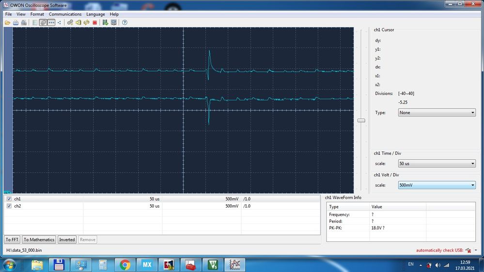

Hello, friends! I have read and tried to become the attempt you recommended. This is what I see on the oscilloscope:
In NORMAL transmission mode, where channel # 1 is CANH and channel # 2 is CANL. Like the chart from the recommended article. In the LOOPBACK transmission mode, I see a normal schedule on the CANH and CANL channels. I also noticed that if you just listen to the CAN line, without sending anything there, and at the same time, forming parcels using the Can King special software. Then these parcels, my assembly STMCUBEMX 6.0.1 pack 1.8.3 for the Stm32F103C8t6 chip (and TJA1050) does not receive and there is no interruption for receiving parcels. How to tie all this information into one and correct the error, while I do not have an understanding? Thank you all in advance for your help! Thank you for understanding!
