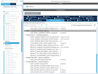

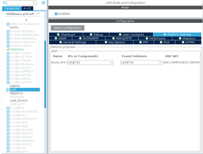

LWIP enables . in that DHCP disabled
shreya_awati_1-1780551421373.pngshreya_awati_2-1780551439678.pngshreya_awati_3-1780551454303.pngshreya_awati_4-1780551461685.png

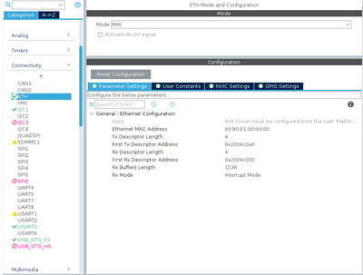

Ethernet is enabled . didnt changed anything .

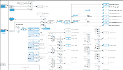

Clock configuration

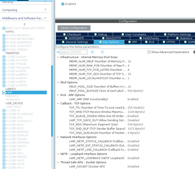

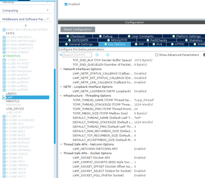

For use above API's i enabled FREERTOS in MX and then LWIP_SOCKET option is automatically enabled.

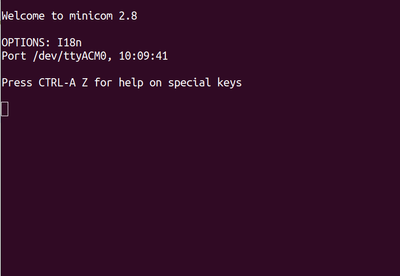

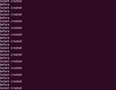

but i added USART3 for debugging , so on minicom terminal print is not coming.
But when i disable FREERTOS that time USART3 print is displyed on minicom terminal , but not able to enable  LWIP_SOCKET option in MX .
[Expected behavior] : simple socket based communication
Server is in listen mode . client can be connect and simple communication is done .
[How to reproduce]  : above i shared steps to" what i trying to do" you can follow those steps.

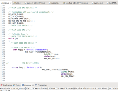

client .c
	  int sock;
	  struct sockaddr_in server_addr;
	  char tx_buffer[100];
	  char rx_buffer[100];
	  strcpy (msg , "before Socket created\r\n");
	  	 	  	      HAL_UART_Transmit(&huart3,
	  	 	  	                        (uint8_t*)msg,
	  	 	  	                        strlen(msg),
	  	 	  	                        HAL_MAX_DELAY);
	  sock = socket(AF_INET, SOCK_STREAM, 0);
	  strcpy (msg , "after Socket created\r\n");
	  	 	  	                        (uint8_t*)msg,
	  	 	  	                        strlen(msg),
	  	 	  	                        HAL_MAX_DELAY);
	  if(sock < 0)
	      char msg[] = "Socket Failed\r\n";
	      HAL_UART_Transmit(&huart3,(uint8_t*)msg,strlen(msg),HAL_MAX_DELAY);
	  server_addr.sin_family = AF_INET;
	  server_addr.sin_port   = htons(5000);
	  inet_aton("169.254.0.220",&server_addr.sin_addr);
	  strcpy (msg ,"before connect created\r\n");
	  	 	  	                        (uint8_t*)msg,
	  	 	  	                        strlen(msg),
	  	 	  	                        HAL_MAX_DELAY);
	  if(connect(sock,(struct sockaddr*)&server_addr,sizeof(server_addr)) < 0)
	      char msg[] = "Connect Failed\r\n";
	                        (uint8_t*)msg,
	                        strlen(msg),
	                        HAL_MAX_DELAY);
	  else
	      char msg[] = "Connected\r\n";
	                        (uint8_t*)msg,
	                        strlen(msg),
	                        HAL_MAX_DELAY);
	  while(1)
	      strcpy(tx_buffer, "Hello From STM32");
	      send(sock,
	           tx_buffer,
	           strlen(tx_buffer),
	           0);
	      int len = recv(sock,
	                     rx_buffer,
	                     sizeof(rx_buffer)-1,
	                     0);
	      if(len > 0)
	          rx_buffer[len] = '\0';
	                            (uint8_t*)rx_buffer,
	                            strlen(rx_buffer),
	                            HAL_MAX_DELAY);
	                            (uint8_t*)"\r\n",
	                            2,
	                            HAL_MAX_DELAY);
	      HAL_Delay(1000);
