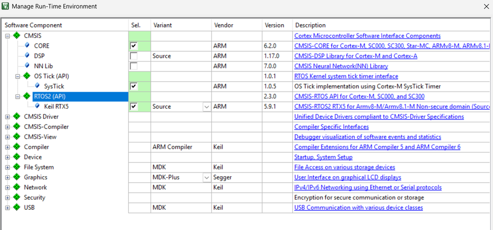

I am a user of the NUCLEO-N657X0-Q board.
I would like to use Keil MDK RTX5 RTOS together with Root of Trust.
My development environment is as follows:
1> Development tool: Keil uVision V5.42
2> Example source: STM32Cube\Repository\STM32Cube_FW_N6_V1.2.0\Projects\NUCLEO-N657X0-Q\Applications\ROT\OEMuROT_Appli
3> Development board: NUCLEO-N657X0-Q
4> Manage Run-Time Environment Setting

}When executed, the serial messages appear for a while and then stop, and the SecureFault_Callback() function is called, after which the program does not proceed any further.
I am inquiring about the issue of the program stopping. Thank you.
