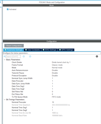

We are busy making a setup with 2 nucleo-c092rc boards. Our first test was to send from board 1 to board 2 by the integrated CAN interface on these boards. We started at 1Mbits and this worked great. Also on 4Mbits the setup worked great. But we also want to test this on 8Mbits and now the transmitter is not sending correctly. We only see that the arbitration phase is send out and a couple of bits of the data part, but then the transmitters stops sending.
We have tried with internal HSI(48Mhz) and external HSE crystal which is also 48Mhz on the nucleo boards.
We calculated the values for the SyncJumpWidth and timeseg1 and 2 and also tested with values slightly altered.
hfdcan1.Init.DataPrescaler = 1;
hfdcan1.Init.DataSyncJumpWidth = 2;
hfdcan1.Init.DataTimeSeg1 = 2;
hfdcan1.Init.DataTimeSeg2 = 3;
But we allways have the same outcome. Sometimes it's not sending anything and sometimes only a small part of the
total message of 64 bytes.
What could be the issue here?

1 ACCEPTED SOLUTION
Accepted Solutions
mƎALLEm
-> you need definitely to use HSE instead of HSI for CAN communication.
I invite you to refer to this knowledge base article: STM32 FDCAN running at 8 Mb/s on NUCLEO boards
Refer to the Github hotspot: CKB-STM32-FDCAN-8Mbs
The NUCLEO-C092 board is not included as example but the same principle applies to it.
Meanwhile and at first glance, you didn't activate the transceiver delay compensation:

mƎALLEm
For your intention, your ioc file doesn't reflect the code source you are sharing.
So anyone wants to regenerate the project or modify something will overwrite your configuration.
May be you've attached the wrong project (the old one).
mƎALLEm
Could you please state on this thread?
