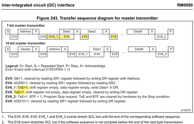

while (!I2C1_SR1_TXE_READ()) Code enters infinite loop in this control, TxE bit is never set. What should I do to assure it will be set?
2025-01-04 7:41 AM
You're not providing the full picture here. TXE won't be set until you send the address. Have you done that? Can you show a logic analyzer trace of SDA/SCL?
The reference manual is very explicit about what happens when during a transmission. In the case of a master i2c transmission, see here:

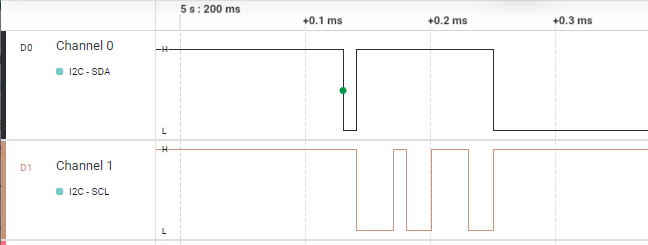

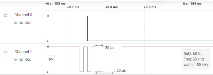

2025-01-08 9:37 AM
Those SDA/SCL traces are not valid. Something is bad with your configuration. Do you have external pullups? I'd check GPIO settings in the registers to ensure OD AF mode is set. Perhaps do an analog capture, should see a fast falling edge and slow rising edge on both lines.
If it works with HAL, clearly a bug in your code, and you're the only one with insight into that. We can't see what you don't show us.
Perhaps compare I2C1 register settings with HAL to those with your own code. Should be able to spot differences quickly.
