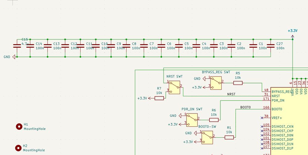

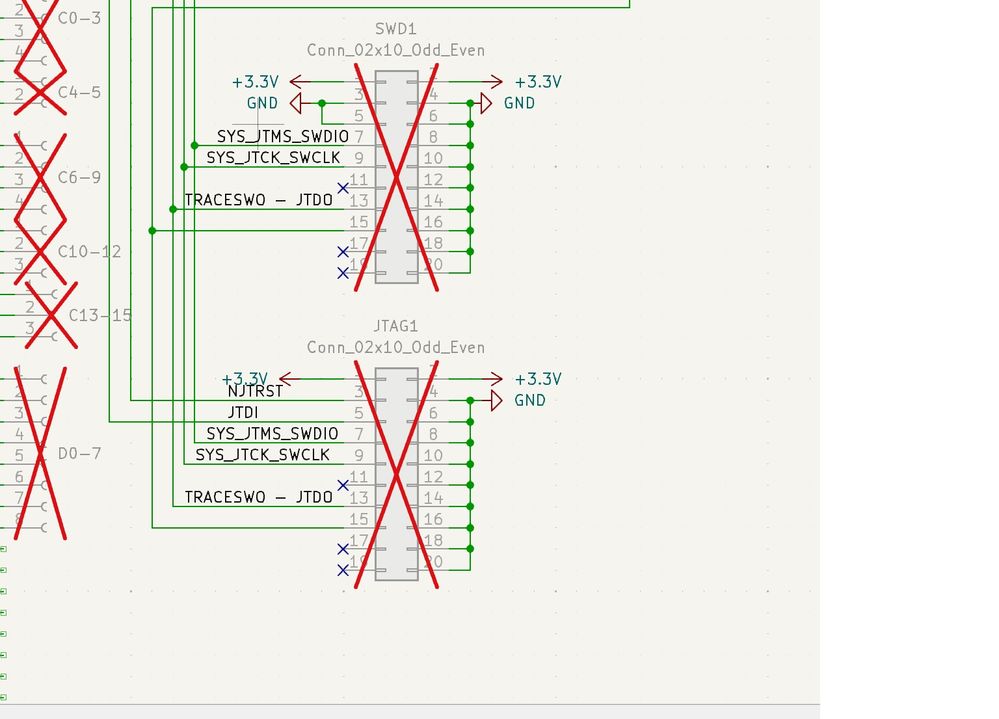

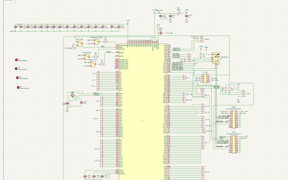

HI! I have my wiring below and I wonder what is wrong with it. Hope someone can give me some help!! my BOOT0 -> LOW, PDR_ON -> HIGH, BYPASS_REG -> LOW. And I have the following connections to the ST LINK:
NRST - SWDIO - SWCLK - TRACESWO.

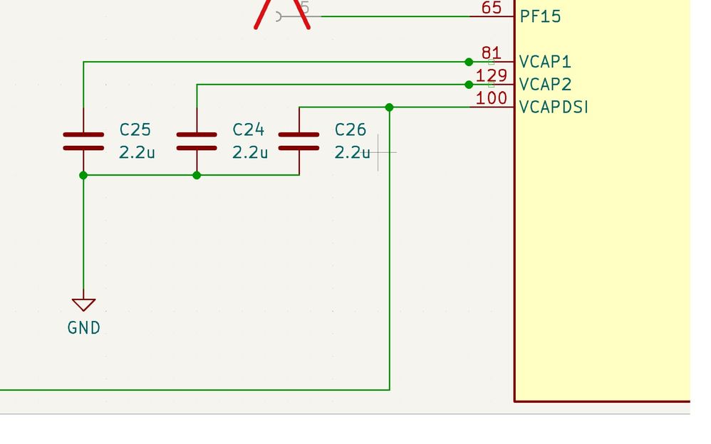

Check voltage present on VCAP pin, and capacitors

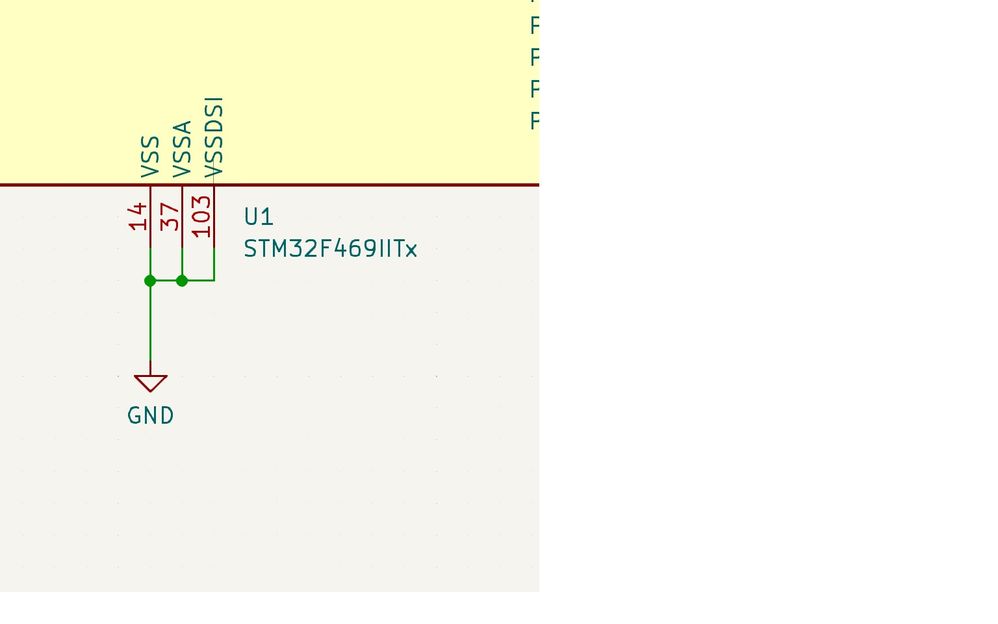

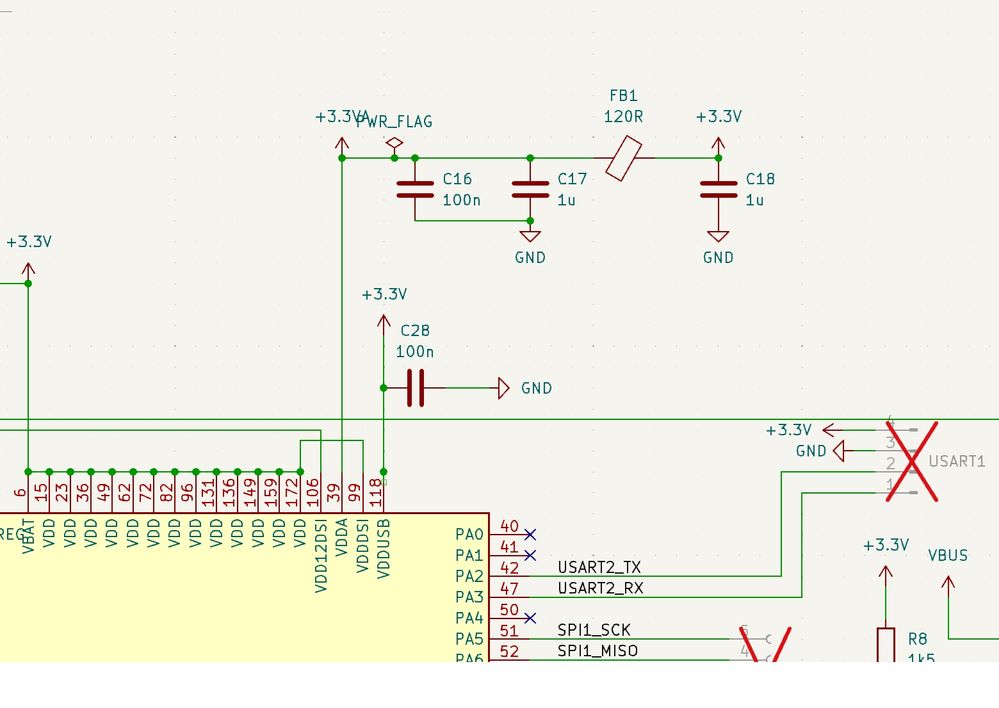

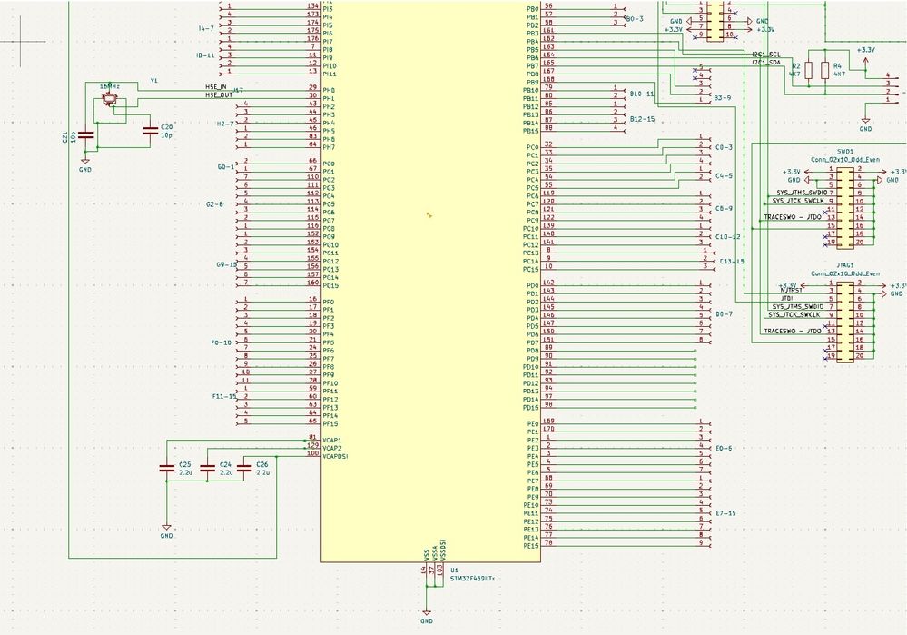

Provide a schematic, constrained to the STM32 if that's simpler, so we can better understand what you've built.
A large, clear and in-focus picture of the board with the part in-situ will also be illustrative.
The ST-LINK expects to see a target voltage on pin 1 or 2 of the standard JTAG 20-pin connector.

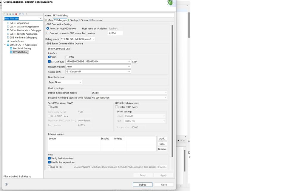

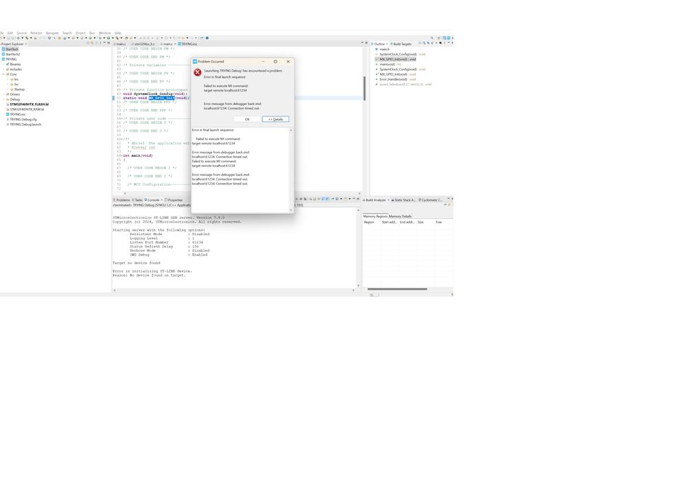

If you're getting connectivity issues in STM32 Cube Programmer, please show that whole screen, along with error message.

(I Have the same values at the pin and at the capacitor)
VCAP2 -> 360mV when I insert the probe, then it drops to 312mV.
VCAP1 -> 480mV.
NRST -> 396mV.
The total drawn read in the power supply is 0.07A.
