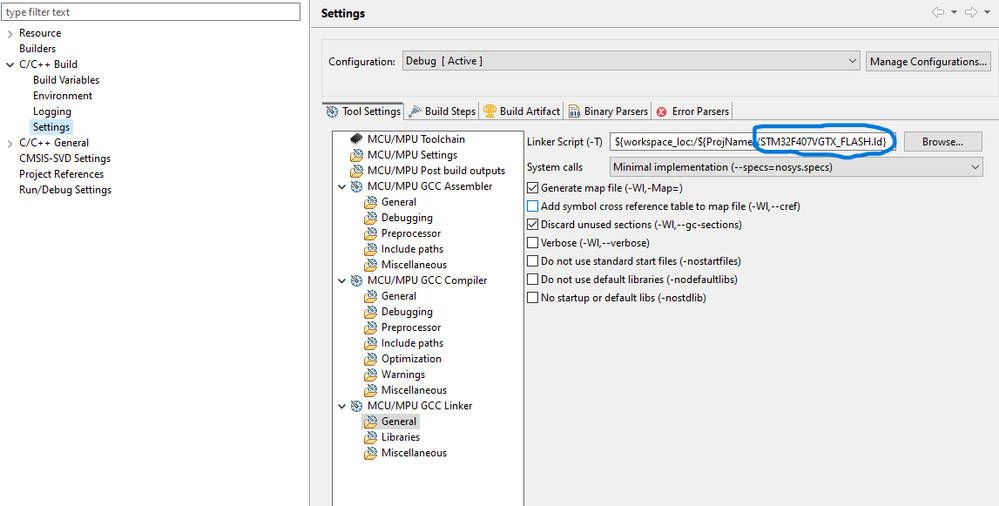

I checked my project uses either FLASH or RAM by looking here.
In my STM32F407VGTX_FLASH.ld file. It seems OK.

OK, this looks reasonable (Linker Script for booting from flash).

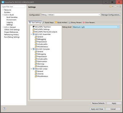

Find the "Debug level" settings and "Optimization" (set for debug). For ResetHandler, which is in assembly file "startup.S" - you have to select also -g3 in the Assembler part config.
2025-01-01 12:32 PM - edited 2025-01-01 12:32 PM
"Debug level" in the above had been already set as "-g3" and also optimization level was (none-O0). @tjaekel

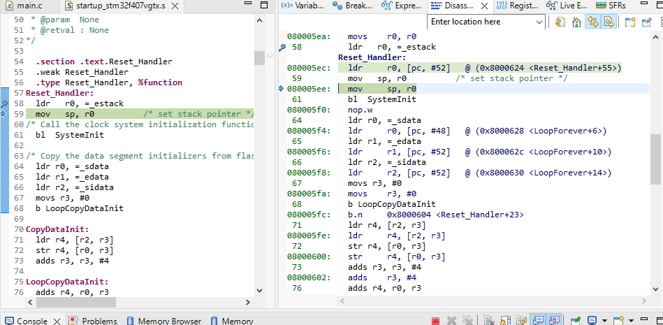

Set optimization to "Optimize for debug (-Og)".
You should be able to see the Reset_Handler code (the assembly code).
There is a way to show the "Disassembly" and to step trough on single assembler instructions.
Find the Reset_Handler entry address in flash ROM: it should be the second 32bit in vector table (memory dump at 0x08000000). The second word is address where Reset_Handler starts (the first the top address of SP).
Use Disassembly view and single assembler instruction steps.
If you do not see any Reset_Handler - it would look strange to me. Maybe you do not have a startup.S file?
Does it jump immediately to main()? There must be a startup sequence which copies code and data from flash ROM into RAM.

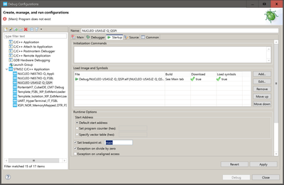

In the debugger configuration is also an option to set a breakpoint at Reset_Handler (and not just main):
Can you see the Reset_Handler code and step from there?
2025-01-01 2:47 PM
08000526: movs r0, r0
main:
08000528: push {lr}
0800052a: sub sp, #28
33 GPIO_Handle_t I2C1_SCL_PB6 = { .PORTNAME = GPIOB,
0800052c: ldr r3, [pc, #144] @ (0x80005c0 <main+152>)
0800052e: add.w r12, sp, #12
08000532: ldmia.w r3, {r0, r1, r2}
08000536: stmia.w r12, {r0, r1, r2}
42 GPIO_Handle_t I2C1_SDA_PB7 = { .PORTNAME = GPIOB,
0800053a: mov r4, sp
0800053c: adds r3, #12This is disassemble view, it indicates line6 at the beginning.
This is memory view.
I replaced Reset_Handler with main in the debugger configuration, I can move forward step by step from here. @tjaekel
