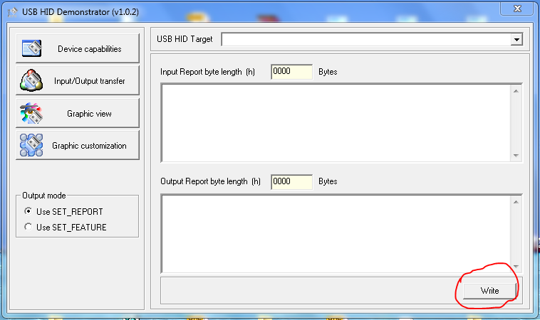

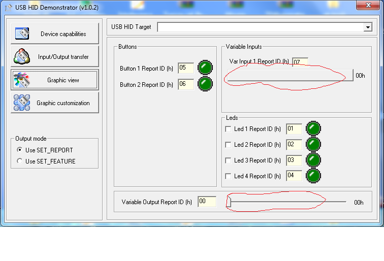

allow to the microcontroller to communicate with the USB HID application. But some features don't work. I want to control the trimmer and the gauge, and collect data after clicking the Write button. So what are the necessary modifications that i have to do to make the application running.2013-03-28 4:55 AM
I found the way to communicate with all elements of the application. But now can anyone explain us how the PC receive and transmit data (an example of code will be very helpful) ???
