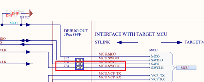

Ok try to disconnect STLINK from the target MCU:
By removing JP4 (UM3353:(
From the board schematic:
Removing JP4 disconnects SWCLK from STM32C092.

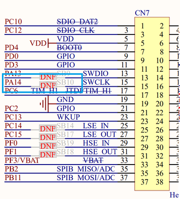

And you need to solder the solder bridge SB14 to connect the BOOT0 pin to CN7 connector.
