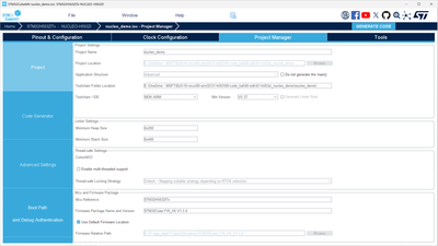

As the title suggests, the demonstration program is generated from the options shown in the following figure.
After the program is burned onto the board, it won't run. It enters the debug mode and stops at the "SystemInit" point. After clicking continuously several times, it will then enter the "main" section.
Any help would be appreciated as I am losing hair over this haha.

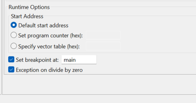

Make sure you are using the latest version of STM32CubeMX (version 6.15.0 ).
Additionally, configure STM32CubeIDE so that the debugger starts at the main function instead of stopping at SystemInit. To do this, open your project's debug configuration in STM32CubeIDE, navigate to the Startup tab, and enable the option labeled "Set breakpoint at main". This will ensure the debugger automatically halts at the beginning of your main application code
THX
Ghofrane

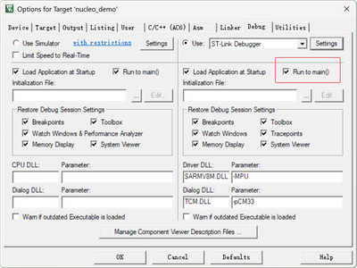

I am using version 6.15, but the IDE is Keil.
Keil also selected the relevant options, but it had no effect.
I used the MCU option of Cubemx to create a simple LED blinking project for H563ZI, and there were no issues at all.
I'm not sure where the problem lies with the demonstration program. Thank you for your response.
