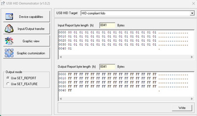

I also tested sending data using the USB HID Demonstrator (v1.0.2) software.
The GET_FEATURE command works, but SET_REPORT does not seem to trigger any callback on the firmware side.

I have also tested with STMicroelectronics' USB HID Demonstrator tool and can see that data is successfully transmitted from the STM32 board to the host. However, when I send data using the SET_REPORT command, the associated callback function is not invoked; only the SET_FEATURE function works.

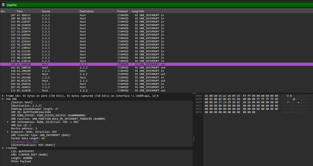

2025-05-19 9:20 AM
I observed with Wireshark that when I initiate the enrollment step with WebAuthn, the host sends data to the OUT endpoint :
The issue is that the USBD_Custom_HID_SetReport callback function in my program is not being called.
If you have any insights or suggestions to resolve this problem, I would appreciate your assistance.

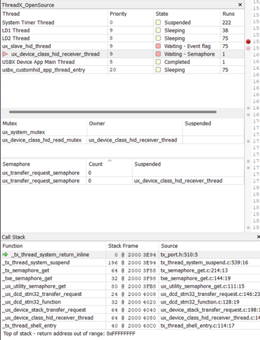

While debugging, I noticed that the ux_device_class_hid_receiver_thread goes into a semaphore wait state and remains blocked, even when registering on WebAuthn. Yet, with Wireshark I can clearly see data arriving on the OUT endpoint.
I placed a breakpoint on the return statement of the USBD_Custom_HID_SetReport function in the file ux_device_customhid.c, but it never gets triggered.
