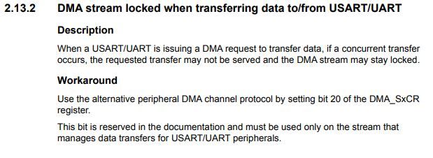

Have a look also to the STM32H7 errata sheet and check if you have the same conditions as described here:
Hope my answer helped you! :smiling_face_with_smiling_eyes:

I have this condition (DMA stream locked). Can you help me please to solve it? How to enable bit 20 of DMA_SxCR register? Maybe I use the incorrect DMA stream? Thanks.
