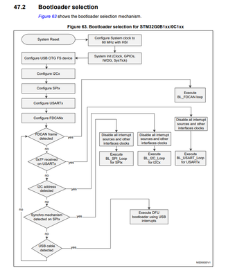

At startup, the STM32 bootloader samples all supported interfaces in a fixed order: FDCAN, USART, I2C, SPI, and USB. It locks onto the first protocol where valid activity is detected—such as a FDCAN frame or a USART sync byte—and disables all other interfaces for that session. If no valid activity is detected on FDCAN, the bootloader continues to check the next interfaces in sequence until one is activated, and the selected protocol remains active until the next reset.
Please see the diagram below:
