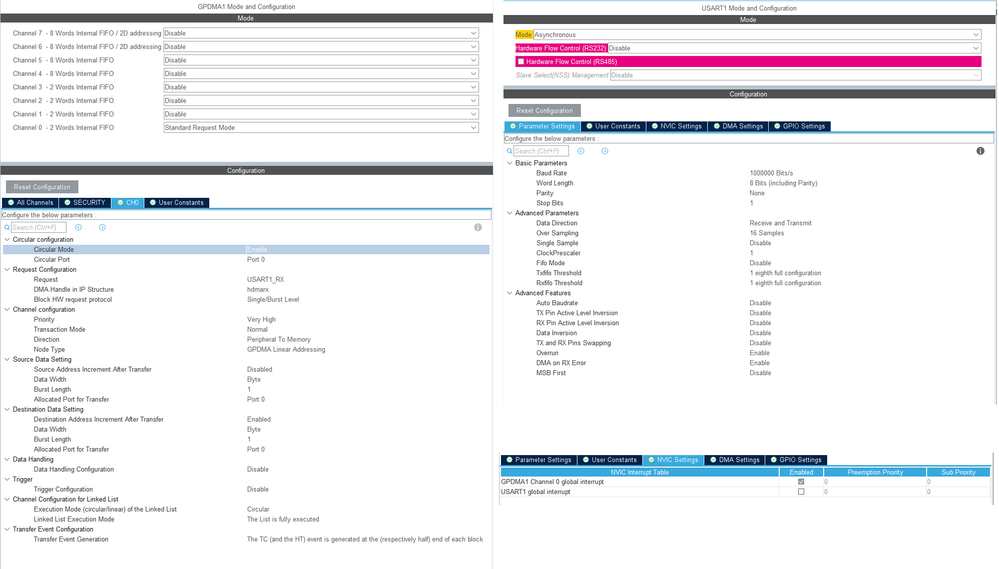

I'm working on a custom board with an STM32H563 and using CubeMX, HAL, and ThreadX.
I am trying to receive variable-length UART data via DMA using HAL_UARTEx_ReceiveToIdle_DMA(). My problem is that the HAL_UARTEx_RxEventCallback never triggers for the HAL_UART_RXEVENT_IDLE event. It only triggers for HAL_UART_RXEVENT_HT (Half Transfer) and HAL_UART_RXEVENT_TC (Transfer Complete).
Setup
Here is the .ioc

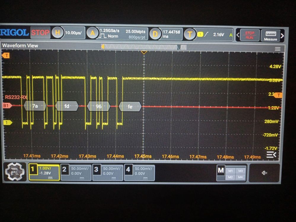

Here is the RX line on the scope:
Problem
Expected Behavior: Given the long idle time, I expect HAL_UARTEx_RxEventCallback to be called with an event type of HAL_UART_RXEVENT_IDLE after each packet.
Actual Behavior: The IDLE event never fires. I only get Half Transfer and Transfer Complete events (so when the buffer is half full or full).

2025-11-12 5:03 PM - edited 2025-11-12 5:04 PM
Hello @Guenael Cadier,
Thank you for your response. Your suggestion to investigate the USART1 IRQ was correct and led me to the solution.
The issue is now resolved.
The Solution (TL;DR)
I enabled the USART1 global interrupt in CubeMX, as you suggested this is mandatory for IDLE detection.
This initially caused the UART to enter an error state on startup (details below), which is why all interrupts seemed to stop.
I fixed this by implementing HAL_UART_ErrorCallback() to re-arm the DMA reception immediately after an error is detected.
Here is the code added to main.c:
void HAL_UART_ErrorCallback(UART_HandleTypeDef *huart)
if (huart->Instance == USART1)
// Re-start the DMA reception.
if (HAL_UARTEx_ReceiveToIdle_DMA(huart, huart->pRxBuffPtr, huart->RxXferSize) != HAL_OK)
// Handle the case where re-arming fails
}Detailed Explanation
After enabling the USART1 IRQ, I observed that HAL_UART_ErrorCallback was being triggered immediately on startup, mostly with HAL_UART_ERROR_NE (Noise Error).
My peripheral sends a continuous stream of data bursts, and it appears one of these bursts was active during initialization, immediately placing the UART peripheral into an error state. By default, the HAL driver does not automatically recover from this state, which is why enabling the IRQ seemed to "stop all interrupts."
By implementing HAL_UART_ErrorCallback and re-starting the HAL_UARTEx_ReceiveToIdle_DMA transfer, the driver now correctly handles this initial error, recovers, and successfully detects the IDLE line events as expected.
Follow-up Question: As an optimization, is there a better method to clear the error state and resume reception within the error callback, other than calling the full HAL_UARTEx_ReceiveToIdle_DMA function?
Thank you for your help.
2025-11-10 12:21 AM
Hello @mipi
In order to have HAL_UARTEx_ReceiveToIdle_DMA() working as expected, it is mandatory to have USART1 IRQ enabled : IDLE event will be detected using IDLE interrupt at UART level.
If you enable it using MX, USART1_IRQn should be enabled durint HAL_UART_Init() call so prior any communications.
Now, if you mentioned "Enabling it stops all UART interrupts", I think it is the part that needs to be investigated.
What do you mean ? no reception at all ?
Could you check content of USART1_ISR when it occurs ? (to check if OverRun error flag is raised).
Regards
