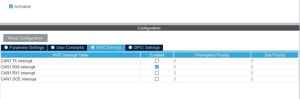

Thank you DOCon.1 for your reply.
I m using cubeMax for pin configuration and atollic trueStudio for development.
It is entering in sleep mode successfully but not coming out from sleep mode when next expected CAN data is received. as shown in above code.
Kindly find image of NVIC setting.
