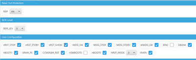

Hello everyone, for a few days I have been struggling with skipping and running the bootloader on stm32g474ret6 via usart.
I have an STM, 12MHz crystal, and an FTDI chip on my own PCB, with RTS/CTS disconnected for now. After sending a command via USART, the control LED lights up, but the bootloader doesn't start. What am I doing wrong?

2025-11-09 4:12 PM
Don't jump from within an interrupt context. Set a flag and jump from the main thread instead.
Don't disable interrupts without re-enabling them.
Working jump to bootloader code is here:
How to jump to system bootloader from application ... - STMicroelectronics Community
2025-11-09 4:12 PM
2025-11-11 4:39 AM - edited 2025-11-11 4:45 AM
Thank you for letting me enter the bootloader. I didn't get to a single registered error :) But the problem, which is again related to exiting the bootloader, is that the bootloader doesn't respond to GO commands at all. I tried nvic reset, and the vector array at address 0x08000200 doesn't work either, as if something connected. According to user 'kfrosh', trying to systick after RCC_deinit doesn't work either. I thought the UART was working, but when the bootloader is enabled, it communicates via UART via the stm32prg without any problems.
