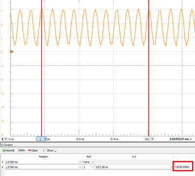

2024-02-26 4:36 PM
I was able to set the MCO from HSE and it measures 16MHZ
So I am not sure why the UART baudrate changes when I use the HSE clock source
