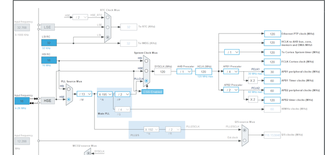

2024-02-22 8:48 PM
Thanks for the reply.
I am using a real XTAL. I updated the clock config according to this
I updated my PLLM to 13 and PLLN to 195 as per the above config, but still I am not getting proper comms out of the UARTS

OK, this looks good.

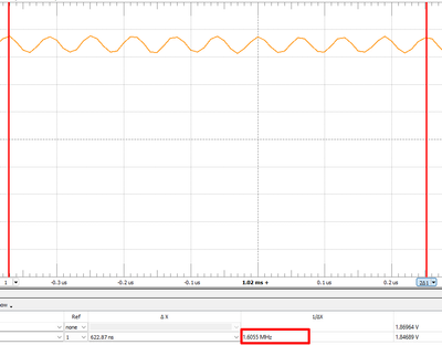

2024-02-25 3:32 PM
I have measured the RCC_OSC_IN which is 16 MHz,
1.6055 MHz x 10 = 16MHz.
Currently in our board PA8 and PC9 are used for i2c comms, So I cant enable MCO1 and MCO2 for measuring the clock output.
