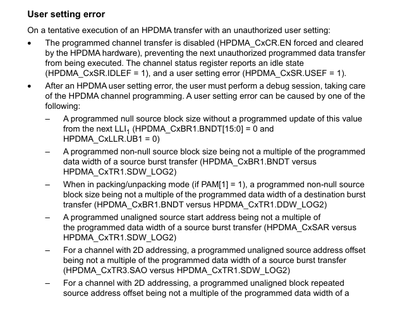

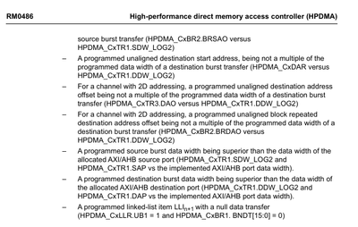

Saket_Om
Hello @rphii
Please refer to the example below:
STM32CubeN6/Projects/NUCLEO-N657X0-Q/Examples/DMA/DMA_RAMToRAM at main · STMicroelectronics/STM32CubeN6
For the user setting error please refer to the root cause possible in the RM0486:
Saket_Om
