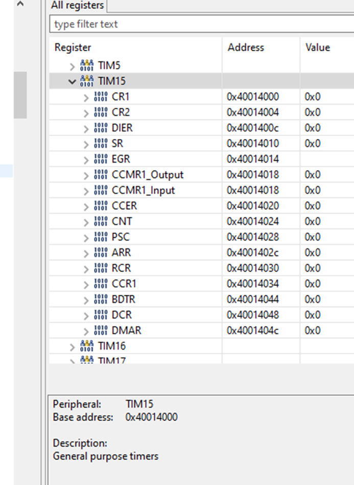

Also I would like to know if you can explain why in the debugger on TIM15 the SFR register tab does NOT show or give access to SMCR? I have attached a pic of this as well. I am using HAL stuff here and although I cannot see it in SFR I can create a dummy variable temp and read it......Note register 008 is missing
