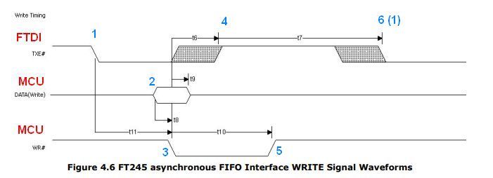

The communication protocol is simple (from FT2232H datasheet):

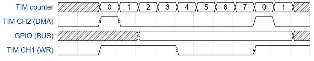

Core mechanism in STM32F446:
Once the timer completes the predetermined number of periods (repetition counter), it stops and triggers an interrupt
In the interrupt routine, the program determines how much data needs to be sent and sets the repetition counter accordingly and starts the next transfer (enable timer).
Since the timer always sends a predetermined and selectable amount of data (period, DMA requests), there is no risk that the application will lose track of the amount of data sent. For example, when sending 520 bytes of data, 520 is set in the DMA->NDTR, the first burst will have RTR="256", the second also RTR="256", and the third RTR="8".
The transfer takes place in "bursts" determined by the RTR value of the timer. Typically, the largest possible RTR is selected if there is a lot of data. However, RTR is limited to 256 on older chips, while newer chips allow for higher values.
Test program runs at 180MHz and sends 8*1024 of 4kB buffers. PC app reads them, measure transfer time and check data integrity. PC app have to be ready before MCU start transmitt. MCU waits until PC sends one byte to FTDI which assert RXF flag. Reading from FTDI is not implementet in this exaple, but it is trivial in bit-bang style.
In this configuration i was able to reach more then 7.5MB/s and probably with some optimalisation of IRQ routine, or using MCU with greater repetition counter it can probably be almost theoretical maximum 8MB/s. PC app is included in attachment (plain C, FTDI D2XX libraries), but it can be read also by VCP. VCP terminals probably will limit transfer speed.

* External signal (TXE line from FTDI) gates TIM1 (low level enables counting)
* TIM1 runs in one-pulse mode with repetition counter 256
* TIM1 generates internaly DMA requests from CH2 (as soon as posible after period start, therefore CCR2=1)
* DMA transfers (parallel) data from memory buffer to GPIO
* TIM1 generates PWM on Channel 2 (WR line to FTDI). Falling edge signalise data write command to FTDI. The falling edge moment is selected so that the DMA has time to complete writing data to the GPIO (+ setup time elapsed).
* If external signal (TXE) sets to H (FTDI signals that it is not ready to receive data), timer is paused (not gated). When TXE become L, timers continue in run (and transmit)
* Once the timer completes the predetermined number of periods (repetition counter), it stops and triggers an interrupt.
* In the interrupt routine, the program determines how much data needs to be sent and sets the repetition counter accordingly and starts the next transfer (enable timer).
* Since the timer always sends a predetermined and selectable amount of data (period, DMA requests), it is possible to reasonably check whether all the necessary data has been sent.
* For example, when sending 520 bytes of data, 520 is set in the DMA, the first burst will have RTR="256", the second also RTR="256", and the third RTR="8".
* The transfer takes place in "bursts" determined by the RTR value of the timer. Typically, the largest possible RTR is selected if there is a lot of data. However, RTR is limited to 256 on older chips, while newer chips allow for higher values.

// start data transfer (indication in transfer_status)
char transfer_start(void){
uint16_t transfer_size=4096; // copy total transfer size (now it is fixed, can be function parameter)
datacounter = transfer_size; // copy "bytes to send" to downcounter
// check if buffer is greater then burst size
if(datacounter > 256){ // next burst is "full size"
LL_TIM_SetRepetitionCounter(TIM1, 255);
datacounter = datacounter - 256; // remaining bytes to send
}else if(datacounter>0){ // next burst i "partial size"
LL_TIM_SetRepetitionCounter(TIM1, datacounter);
datacounter = 0; // last data to send
}else{ // that shouldnt happen (who wants to transfer 0 bytes ?)
return 1;
// set DMA
LL_DMA_SetMemoryAddress(DMA2, LL_DMA_STREAM_2, (uint32_t)buf); // set buffer address (now fixed, can be function parameter)
LL_DMA_SetDataLength(DMA2, LL_DMA_STREAM_2, transfer_size); // set total number of bytes to transfer
// for safety, clear and update counter registers
LL_TIM_SetCounter(TIM1, 0);
LL_TIM_DisableIT_UPDATE(TIM1);
LL_TIM_GenerateEvent_UPDATE(TIM1);
WRITE_REG(TIM1->SR, ~(TIM_SR_CC1IF | TIM_SR_CC2IF | TIM_SR_UIF));
LL_TIM_EnableIT_UPDATE(TIM1);
// running transfer indication
transfer_status=1;
// enable transfer
LL_TIM_EnableDMAReq_CC2(TIM1);
LL_DMA_ClearFlag_HT2(DMA2); // all flags must be cleared to enable DMA (!!!)
LL_DMA_ClearFlag_TC2(DMA2); // i am clearing only two of them - :/
LL_DMA_EnableStream(DMA2, LL_DMA_STREAM_2);
LL_TIM_EnableCounter(TIM1); // from now, transfer is running
return 0;
// stop transfer (called when all bytes are out)
void transfer_stop(void){
LL_DMA_DisableStream(DMA2, LL_DMA_STREAM_2);
LL_TIM_DisableDMAReq_CC2(TIM1);
LL_TIM_DisableCounter(TIM1);
transfer_status=0;
Of course, I appreciate all comments, especially if I have overlooked any critical issues, etc.
Best regards,
Michal Dudka
