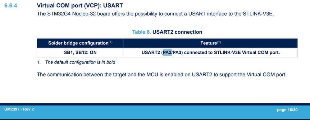

@Andrew Neil wrote:Have you checked that the Nucleo board doesn't have something else on PA2 ?.
Yes, it does:
via: https://www.st.com/en/evaluation-tools/nucleo-g431kb.html#documentation
2025-09-30 4:21 AM
Sorry for late answer. I dont use PA2, and ı tried other pins in timer 2.

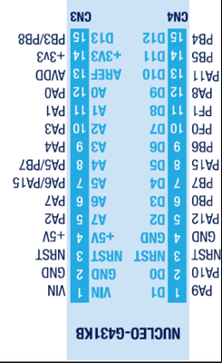

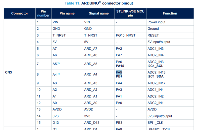

2025-09-30 4:31 AM - edited 2025-10-23 3:23 AM
@cereyanmühendisi wrote:Sorry for late answer. I dont use PA2
Sorry, yes - it's PA5
But do you have the board correctly configured for that?
