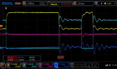

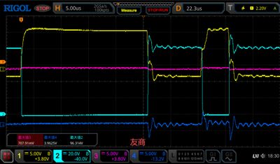

2. Problem Description: During the pulse experiment, the following issues were encountered. The double pulse parameters were (pulse current 400A, bus voltage 80V, auxiliary test inductance 5.6uH). Regarding the following several problems, we also made adjustments to the gate drive but the effect was almost negligible;
Problem One: When the single board was conducting the double pulse test, the waveform exhibited low-frequency oscillation. How to suppress it? We also compared it with the products of a competitor under the same conditions. The competitor was able to suppress this low-frequency oscillation quite well. How to improve this?
Waveform information: CH1 - Lower tube GS, CH2 - Lower tube DS, CH3 - Upper tube GS, CH4 - Current or Upper tube DS.

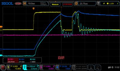

Question 2: During the double-pulse experiment (with a pulse current of 400A), the phase current output exhibited oscillation. How to suppress it?
Waveform channel information: Phase current sampling CH1 - lower tube GS, CH2 - phase current output of the operational amplifier, CH3 - upper tube GS (isolated differential probe), CH4 - inductor current (current clamp)
