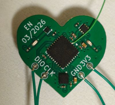

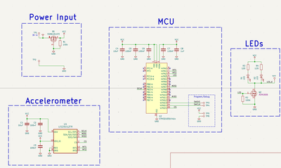

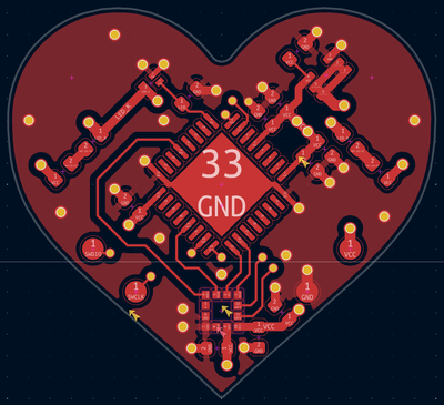

I designed a very simple PCB which has only a few components. I have attached the KiCad files in case it is helpful. I followed guidelines for decoupling capacitors and broke out the SWDIO and SWCLK pins.
The issue I have is this: I can not program/connect to the chip over SWD.
When I power the PCB from 3V, the first noticeable problem is GPIO PA3 goes high. You can notice that because that pin is connected to the gate of a mosfet which is used to switch some LEDs, so when it goes high, the LEDs turn on. It is especially strange because I put an external pulldown resistor on the pin, so the fresh unprogrammed MCU is driving it high for some reason. I also connected my ST Link to the PCB, but when I try to connect with any speed or reset settings, I see this error:

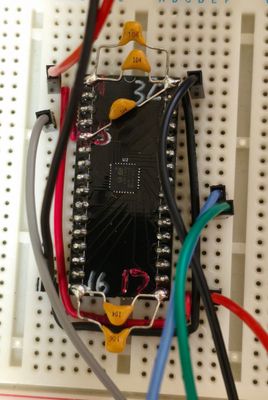

To further try to diagnose the issue, I have soldered another new chip to a DIP breakout PCB I had lying around. I soldered decoupling caps the best I could, but it is still not ideal how far away they are from the chip. I still think it should be a good way to test things though.
Sadly, even with the chip on a breakout I have the same problems! I can not program it, and some GPIO are at weird voltage levels. PA3 is high like my previous attempts. Some other pins are also weird like PB1 is at 2V for some reason, PA5 is at 1.3V, the list goes on. Also, I will mention that I have seen the chip draw between 1mA and 4mA from a 3V supply of my Nordic PPK 2. One time it drew 1mA and some time later after debugging things it randomly is seems to draw 4mA, so not sure what is causing the change.

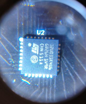

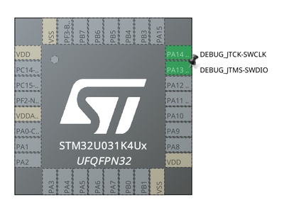

I also thought perhaps I got the orientation wrong, but as far as I can tell I have it right. On my PCB and on my breakout board. I do find it weird that in CubeMX, the ST logo and MPN on the chip are in a different orientation than on the actual chip. However I have double checked the pin I marking on the underside of the MCU and it matches the pin 1 marking dot on the top of the MCU.

Since I could get the MCU on the dip breakout connecting, but not the one on the PCB, I decided to solder a new PCB with the known good chip from the DIP breakout. I also reduced the wire length from the PCB to the programmer, and now I can connect!
I do not need to have the NRST pin connected to the programmer for a successful connection. I also do not need the 100nF cap between NRST and ground, however I will add that in the next revision to be safe.
It seems to me the issue was caused by too long cable lengths from the ST link to the MCU and potentially a damaged chip on the PCB. Either way I am glad it is working, thank you for all the help everyone!

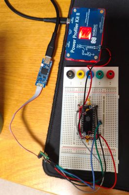

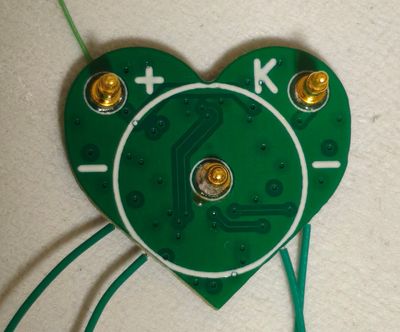

You have pictures of two, as far as I can tell, unrelated setups. One is a heart shaped board and one is rectangular board on a breadboard. Which one are you trying to debug here?
I see, the heart shaped board is the target and the other one is the breakout to further help and debug.
The issue is likely wiring, or chip orientation, or soldering.
Yes that is correct, the heart is the target but I am also trying a breakout board to eliminate the possibility of mistakes in the PCB.

As for chip orientation, I have verified orientation with the pin 1 marking on the top of the package and also by checking the pin 1 marking (chamfered part of exposed pad) on the underside of the chip. Unless the die inside is somehow oriented differently to how the package suggests, I have the orientation correct.
I have checked the schematic and breadboard wiring many times, it looks correct to me. Only thing I can think of is I will check the stlink signals on my scope when I try to connect to verify it is doing something.

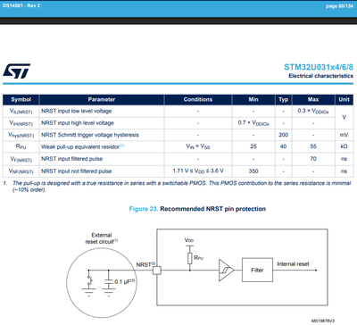

And maybe a 100nF cap on PF2 to gnd , to have longer reset at start.
@EricNava - as recommended in the datasheet:
https://www.st.com/resource/en/datasheet/stm32u031k4.pdf#page=81
That is a good idea, but I don't think it is.
From what I understand, the NBOOT_SEL option bit is set by default so the BOOT0 pin (PF3) should have no effect during boot.
I will try the cap to ground though on reset, that could be the issue. Thanks
