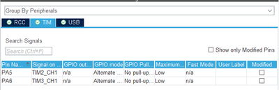

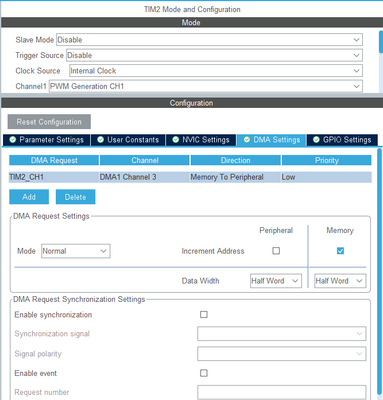

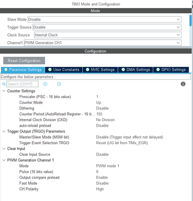

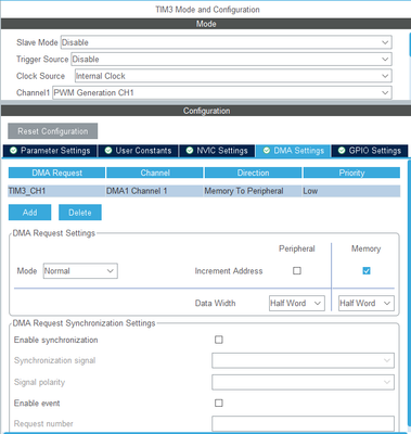

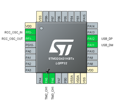

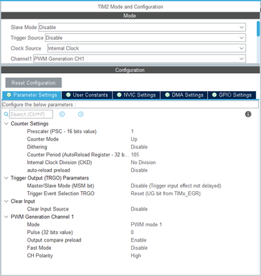

I am driving a Neopixel LED with a PWM signal in DMA mode using a timer. Even though all variables are the same, my code works with timer 3, but the same code doesn't work with timer 2 with the same timer configuration. Why could this be? I checked for a 16-32 bit difference, but they say it's not related to that. I have an STM32G431 Nucleo board. I tried all pin configurations for timer 2 channel 1, but it didn't work. İf it's normally and ı cant use this for neopixel, I will change timer but I use other timers for different jobs with different frequences. But ı dont thinks so.
2025-10-27 1:27 AM - last edited on 2025-10-27 3:11 AM by Andrew Neil
I solved the problem. Thanks for support team. İf anyone else experience this problem;;
This will be fixed when change data width in DMA Settings like this.

And you would need to look up DMA details in the reference manual.
Not every channel/stream can be used with every source/target.

My controller is stm32g431kbt6u. Timer 2 and Timer 3 are use APB1 bus. And they have same calibration in cube mx ui. I use same code. Just change &htimx. Code:

2025-09-30 1:36 AM
Actually ı can take signal. I can see from my ossiloscope. But I guess it's not true. About output pin configutation, I dont now. İts looks like same in Sytem Core-> GPIO.

You still haven't shown your schematic.
Have you checked that the Nucleo board doesn't have something else on PA2 ?
