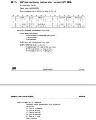

I read the HSPI1->CCR register immediately after HAL_XSPI_Command() returns and confirmed:
HSPI1->CCR = 0x03002101 Breakdown: bits [2:0] = 001 → IMODE = 1-LINE ✓ bits [10:8] = 001 → ADMODE = 1-LINE ✓ bits [13:12] = 10 → ADSIZE = 24-bit ✓ bits [26:24] = 011 → DMODE = 4-LINES ✓ bit [30] = 0 → SIOO = INST_EVERY_CMD ✓
DMODE is confirmed as 3 (quad) in the hardware register. The STM32 HSPI peripheral should therefore be driving all four IO pins as outputs during the data phase. However, the oscilloscope consistently shows only IO0 and IO1 toggling.

Regarding your first question :
HSPI_CCR.DMODE = 0b011 confirms that the STM32U5 HSPI peripheral is configured for a 4-line data phase ( 4 bits at a time (over IO0 to IO3 in quad-SPI mode)), and under normal documented operation it should drive IO0 to IO3 during that phase.
My understanding that there is no typical hidden STM32 mechanism, such as MSEL in CR or DLL calibration state, that would silently downgrade a configured quad transfer into dual output while DMODE still reports quad.
I am forwarding your question to the appropriate team so you can receive more efficient support.
