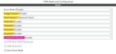

My STM32F303RE is running with an 8MHz crystal feeding into HSE:
Using TIM4 I want to generate 700 interrupts per second, but I only get 318.

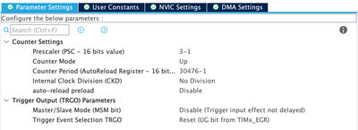

As can be seen TIM4 runs at 64MHz and the following configuration should trigger about 318 interrupts:
Using the following formula:
(edit note - had a typo in the formula)
interrupts_per_second := clock_frequency / (prescaler + 1) / (counter_period + 1)
64 MHz / 3 / 30476 = 700
The 318 interrupts are way off the expected 700 and I just can't figure why. Any ideas are highly appreciated.

2024-01-16 12:13 PM
64M /3 / 30476 = 700 --- seem ok.
+ How you check the rate then ?
try -> set a led toggle in timer int and look with a scope at the pin.
2024-01-16 12:16 PM
How are you monitoring this exactly?
Try clocking from internal HSI to rule out any HSE issues.
Your math (sort of) and expectations check out.
> 64 MHz / 2 / 30475 = 700
Think you made a typo here. Should be 3 instead of 2. Result is the same.
64 MHz / 3 / 30476 = 700.0043750273439 Hz

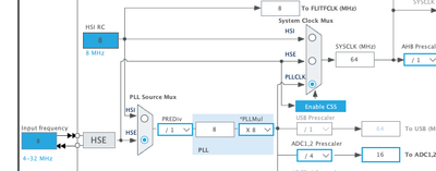

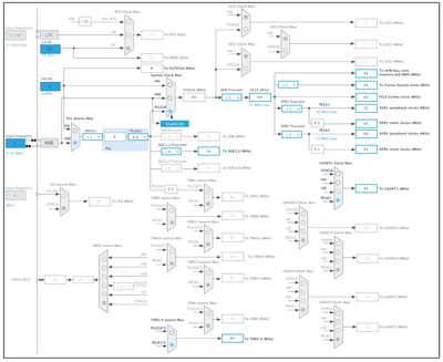

Interestingly I was unable to output PLLCLK and SYSCLK using MCO. Once I use HSE as the clock source for SYSCLK I measure 8MHz which is ok. In my clock setup SYSCLK is generated from PLLCLK so I wonder if there's something wrong with my setup of PLLCLK, but I can't see what it is.
2024-01-18 12:52 PM
Some progress here - the issue with the lacking MCO signal for SYSCLK and PLLCLK was caused by the default speed setting of the MCO output pin PA8 as GPIO_SPEED_FREQ_LOW. Once set to GPIO_SPEED_FREQ_HIGH there's a signal on that pin and I can measure the expected 64 MHz.
So now I know that all clocks are working as expected, just the timer isn't.

I don't recall what the preference is on the F3 for PLL comparison frequency. For the F2/F4 it was 1-2 MHz
You should be able to get PLLCLK/2 out of MCU, and SYSCLK regardless of it's source / generation method.
Unpacking the RCC PLL settings might be more instructive of what's happening internally than Cube clock charts. Perhaps also the generated code.
Assuming this is a NUCLEO board, is that correct, or is this a custom board?
