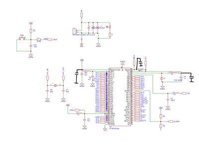

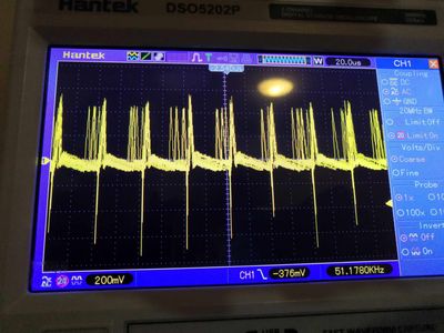

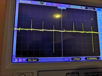

I’ve been working with STSPIN32G4 for while with low voltage (9V), it works good
I set 24V and have problems with nFaults, it being set, meaning that driver is turned off, although no fault is indicated, status register: 10001000
D3 Indicates if the registers had been reset to the default (power-up)
D2, D1, D0 - VDS_P, THSD, VCC_UVLO
black ones are extra 10uF electrolytic capacitors
Vcc=8V DC
VDD = 3,3V DC
What can be wrong or what else should i check?
