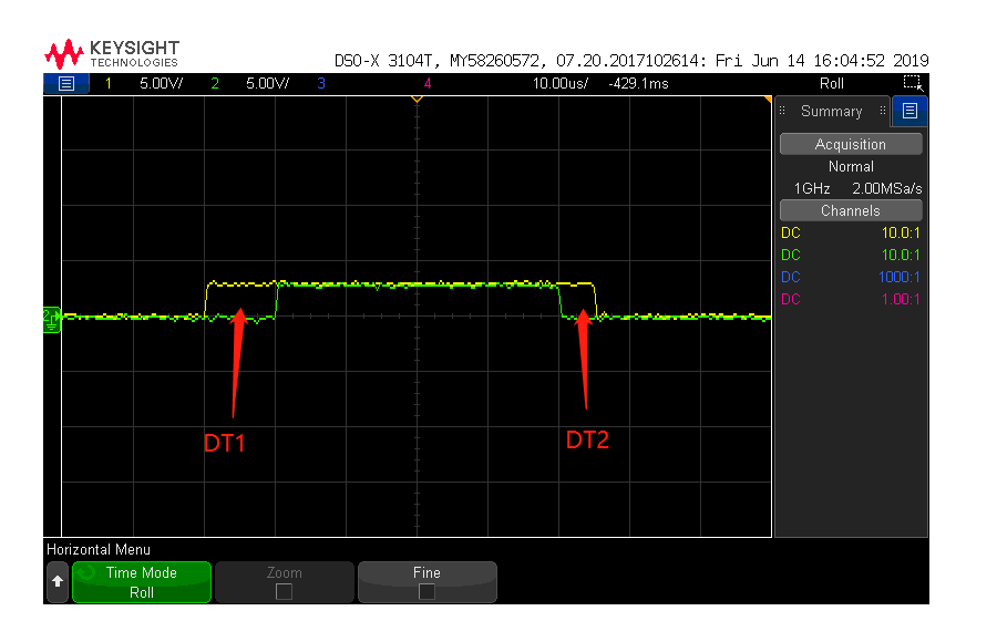

Hello , now I debug about Complementary output with dead-time feature of TIM1 CH1 and CH1N, I set deadtime 5us ,and TIM1's period 50us , then I get scope via oscilloscope ,
but the scope is not what I expect , refer to below , In fact DT1 == 2*DT2 ,
I expect DT1 == DT2 , so I don't know where is not correct ?
THANK YOU !
2019-06-15 1:17 AM
Read out and check/post the timer registers content.
2019-08-06 5:37 PM
config CCER before BDTR can be solved
