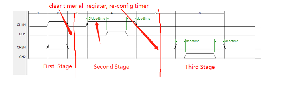

Now , I generate below waveform. Every thing is OK except for red arrow , it indicate a deadtime.but it's longer than other deadtime , in fact , This dead time is twice as large as the other dead time .
divide into three stage :
1�?First Stage , TIM register content
CCMR1.OC2M = 1 ;
CCMR1.OC1M = 1;
CCER.CC1NE = 1;
CCER.CC2NE = 1;
CCER.CC1NP = 1;
CCER.CC2NP = 1;
BDTR.OSSR = 1;
BDTR.MOE = 1;
2�?Second Stage
CCMR1.OC1M = 2;
CCER.CC1E = 1;
CCER.CC1NE = 1;
CCER.CC1NP = 1;
BDTR.OSSR = 1;
BDTR.MOE = 1;
3�?Third Stage
CCMR1.OC2M = 2;
CCER.CC2E = 1;
CCER.CC2NE = 1;
CCER.CC2NP = 1;
BDTR.OSSR = 1;
BDTR.MOE = 1;
when every stage completed , clear all resgister, then ,re-config TIM , re-start .
so. I don't know why the second stage dead time have problem .

config CCER before BDTR can be solved
2019-08-06 12:43 AM
This again as in your previous post, may be an artefact from the way how you set up things. Hard to tell without seeing the actual code, and also I don't have time to analyze this thoroughly.
Try to single-step through the code clearing/setting the timer registers (while having the timer stopped, maybe through the DBGMCU freeze registers) and observe the impact of each register change on the outputs.
2019-08-06 5:22 AM
yes , I have solved !
thanks for your help all the time .
2019-08-06 5:44 PM
