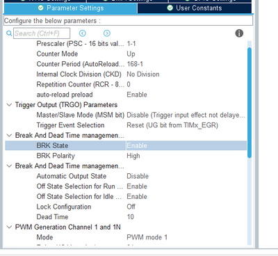

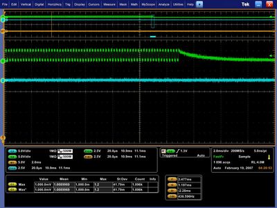

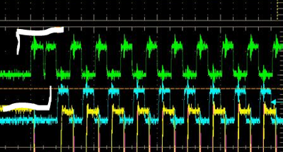

Hello community,
I want to generate PWM with tim8 CH1 and CH1N (complementary) but i have an issue. CH1 pwm first pulse is 2x what it must be. My APB2 clock is 84MHz and i am generating an 500kHz PWM. How to initialize well the PWM with tim 8 to have a good initialization of the CH1 1st pulse.
(Also the last pul doesn't finish well for both channel if i stop and capture on oscilloscope).
Best regards,

htim8.Init.Prescaler = 1-1;
htim8.Init.CounterMode = TIM_COUNTERMODE_UP;
htim8.Init.Period = 168-1;
htim8.Init.ClockDivision = TIM_CLOCKDIVISION_DIV1;
htim8.Init.RepetitionCounter = 0;
htim8.Init.AutoReloadPreload = TIM_AUTORELOAD_PRELOAD_ENABLE;

sBreakDeadTimeConfig.OffStateRunMode = TIM_OSSR_ENABLE;
sBreakDeadTimeConfig.OffStateIDLEMode = TIM_OSSI_ENABLE;
sBreakDeadTimeConfig.LockLevel = TIM_LOCKLEVEL_OFF;
sBreakDeadTimeConfig.DeadTime = 17;
sBreakDeadTimeConfig.BreakState = TIM_BREAK_ENABLE;
sBreakDeadTimeConfig.BreakPolarity = TIM_BREAKPOLARITY_HIGH;
sBreakDeadTimeConfig.AutomaticOutput = TIM_AUTOMATICOUTPUT_DISABLE;
