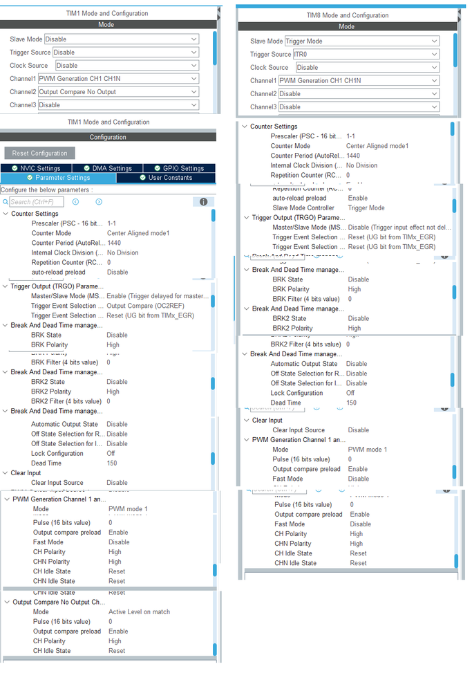

I use STM32 nucleo-f303ze with stm32cubeide , I try to achieve 4 PWM complementary signal with controlled phase shift by potentiometer by using TIM1 channel 1 PWM Generation CH1 CH1N and TIM8 channel1 channel 1 PWM Generation CH1 CH1N
, I use TIM1 channel 2 output compare no output mode, I need to change TIM1 CCR2 in real time with pot.
but it take one value and no change with pot change.
can you help me to do that.

HAL_TIM_Base_Start_IT(&htim1);
HAL_TIM_PWM_Start(&htim1, TIM_CHANNEL_1);
HAL_TIMEx_PWMN_Start(&htim1, TIM_CHANNEL_1);
HAL_TIM_OC_Start_IT(&htim1, TIM_CHANNEL_2);
HAL_TIM_PWM_Start(&htim8, TIM_CHANNEL_1);
HAL_TIMEx_PWMN_Start(&htim8, TIM_CHANNEL_1);
TIM1 -> ARR = 1440;
TIM1-> CCR1 =720;
TIM8 -> ARR = 1440;
TIM8-> CCR1 =720;

htim1.Instance = TIM1;
htim1.Init.Prescaler = 1-1;
htim1.Init.CounterMode = TIM_COUNTERMODE_CENTERALIGNED1;
htim1.Init.Period = 1440;
htim1.Init.ClockDivision = TIM_CLOCKDIVISION_DIV1;
htim1.Init.RepetitionCounter = 0;
htim1.Init.AutoReloadPreload = TIM_AUTORELOAD_PRELOAD_DISABLE;
if (HAL_TIM_PWM_Init(&htim1) != HAL_OK)
Error_Handler();
if (HAL_TIM_OC_Init(&htim1) != HAL_OK)
Error_Handler();
sMasterConfig.MasterOutputTrigger = TIM_TRGO_OC2REF;
sMasterConfig.MasterOutputTrigger2 = TIM_TRGO2_RESET;
sMasterConfig.MasterSlaveMode = TIM_MASTERSLAVEMODE_ENABLE;
if (HAL_TIMEx_MasterConfigSynchronization(&htim1, &sMasterConfig) != HAL_OK)
Error_Handler();
sConfigOC.OCMode = TIM_OCMODE_PWM1;
sConfigOC.Pulse = 0;
sConfigOC.OCPolarity = TIM_OCPOLARITY_HIGH;
sConfigOC.OCNPolarity = TIM_OCNPOLARITY_HIGH;
sConfigOC.OCFastMode = TIM_OCFAST_DISABLE;
sConfigOC.OCIdleState = TIM_OCIDLESTATE_RESET;
sConfigOC.OCNIdleState = TIM_OCNIDLESTATE_RESET;
if (HAL_TIM_PWM_ConfigChannel(&htim1, &sConfigOC, TIM_CHANNEL_1) != HAL_OK)
Error_Handler();
sConfigOC.OCMode = TIM_OCMODE_ACTIVE;
if (HAL_TIM_OC_ConfigChannel(&htim1, &sConfigOC, TIM_CHANNEL_2) != HAL_OK)
Error_Handler();
__HAL_TIM_ENABLE_OCxPRELOAD(&htim1, TIM_CHANNEL_2);

> I use TIM1 channel 2 output compare no output mode, I need to change TIM1 CCR2 in real time with pot. but it take one value and no change with pot change.
Configure CH2 to output a PWM signal if you want it to be a PWM signal. You have it configured to be active on match, not PWM.
TIM1_CCR2 probably does change - and you would "see" that would you set up TIM1_CH2 as PWM - but you don't see its influence on the TIM8 waveform, as it does not influence it.
You have TIM8 in slave-mode controller set to Trigger, that means, that when trigger arrives, TIM8 counter starts (TIM8_CR1.CEN is set in hardware). However, you've already set TIM8_CR1.CEN, and it remains set, so triggers are simply ignored.
One way to proceed is to leave TIM8 slave-mode controller set to Trigger, and set it to One-Pulse mode (TIM8_CR1.OPM=1). That way, after each TIM8 cycle, TIM8_CR1.CEN is cleared in hardware, and the trigger then restarts it. This may cause discontinuities when the trigger's position changes.
Other way is to leave TIM8 running freely, but set its slave-mode controller to Reset.

I suggested enabling CH2 because otherwise CCR2 has no effect on the output as you have it set up.

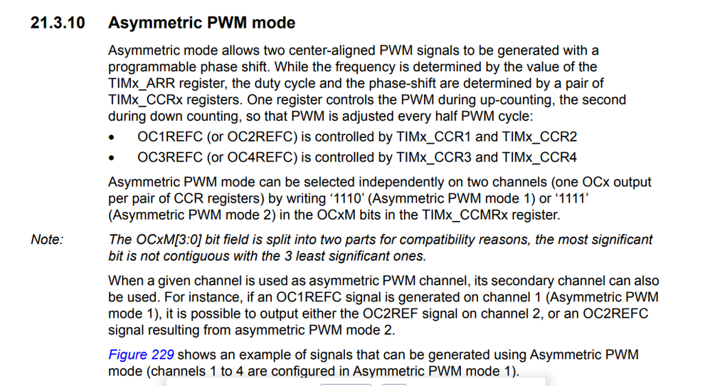

Another option is asymmetric PWM mode. Probably will need to use upcounting timers for that.

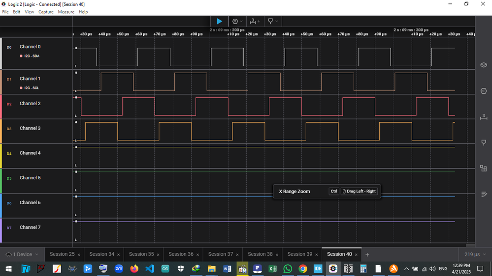

Dear waclawek.jan,
I am very grateful for your response to my question, I tried to working as you mentioned in post,
But the problem still exists as I cannot make the change of phase shift between two complementary pwm of TIM1 & TIM8 signal with potentiometer change.
what is the variable when it changes in value in real time so the phase shift occurs to TIM8 with TIM1?

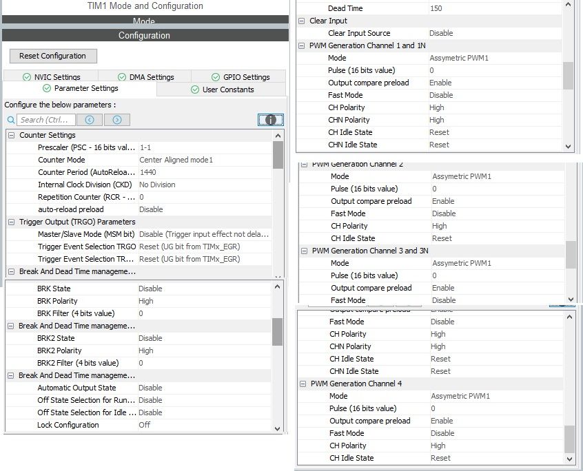

Many thanks for your replying to my question, I try to make asymmetric PWM mode for TIM1 & TIM8 but the problem still exists as I cannot make the change.
2025-04-28 1:18 AM
@TDK I still study RM0316 for stm32f303 manual but I didn't reach the solution. I ask for how TIM1 channels to be configured in asymmetric mode to produce two couples of complementary pwm and How to make dynamically phase shift between them?
2025-04-28 5:45 AM

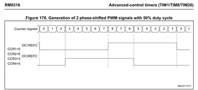

You can't make all 4 signals with TIM1, but you can make 2 with TIM1 and 2 with TIM8 as you've done with your original post. Since each one is independent, you can vary them however you like by changing the appropriate CCRx values.
