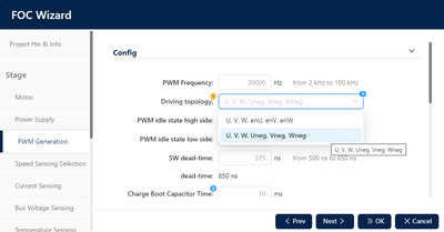

Can I get true 6-PWM (TIM1 CHx + CHxN) working on the X-NUCLEO-IHM16M1 (STSPIN830)?
Jeffrey1
Associate III
I’m using the X-NUCLEO-IHM16M1 BLDC driver board, which is based on the STSPIN830, together with a NUCLEO-F446RE. In the STSPIN830 datasheet, ST clearly mentions that the device supports both 3-PWM and 6-PWM input modes.
But in practice, on this expansion board:
  • Only INU / INV / INW are connected to the MCU
  • ENU/ENV/ENW are present but “NP” (Not Populated) unless manually soldered
  • None of the INxH / INxL pins (the 6-input mode pins) are routed to the Nucleo connectors
  • TIM1 complementary outputs (CH1N/CH2N/CH3N) have nowhere to go
  • Motor Control Workbench only allows 3-PWM mode for this board
The user manual (UM2415) seems to confirm that the 6-input mode requires hardware changes: removing R12, replacing R11, and populating the NP resistors that route INxH/INxL to the MCU. Out of the box, the board is locked to 3-PWM “direct driving” mode.
My question:
Has anyone actually gotten TRUE 6-PWM complementary drive (TIM1 CHx + CHxN with dead-time) working on the X-NUCLEO-IHM16M1?
Not "6 logic inputs", but actual complementary PWM pairs like you’d use for a 3-phase inverter.
If yes:
  • Which resistors/jumpers did you solder?
  • Which pins did you remap on the Nucleo?
  • Did you modify the board to expose INxH/INxL?
  • Does MCSDK support this configuration at all, or do I need to go full custom firmware?
  • And is the internal interlock/deadtime in STSPIN830 going to interfere with MCU-generated complementary PWM?
If this is fundamentally impossible due to how the board is routed, I’d like to confirm that too before I switch to a different driver (DRV8303/8353, IR2101, L6386, etc.).
Anyone who has tried this, please let me know — ST’s documentation is a bit confusing here!

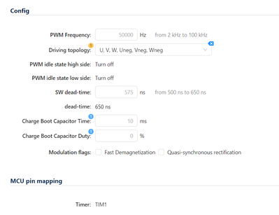

Hello @Jeffrey1,
We are facing an issue on our side on sharing file process.
Create a X-NUCLEO-IHM16M1_HL.json file into the ~user_name\.st_workbench\hardware\board\power directory with following content:

              "type": "DrivingHighAndLowSides",
              "help": "Remove R12 resistor. Set R11 to 0ohm.",
              "cost": 10,
              "signals": {
                "PWM_CHU_H": [
                    "name": "MR23",
                    "help": "CN10.23. Factory default",
                    "cost": 0
                "PWM_CHV_H": [
                    "name": "MR21",
                    "help": "CN10.21. Factory default",
                    "cost": 0
                "PWM_CHW_H": [
                    "name": "MR33",
                    "help": "CN10.33. Factory default",
                    "cost": 0

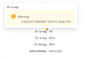

                "PWM_CHU_L": [
                    "name": "MR30",
                    "help": "CN10.30. Factory Default",
                    "cost": 0
                    "name": "MR15",
                    "help": "X-NUCLEO-IHM16M1: CN10.15. Solder R74",
                    "cost": 10
                    "name": "MR11",
                    "help": "X-NUCLEO-IHM16M1: CN10.11. Solder R79",
                    "cost": 10
                "PWM_CHV_L": [
                    "name": "MR28",
                    "help": "CN10.28. Factory default",
                    "cost": 0
                    "name": "MR15",
                    "help": "X-NUCLEO-IHM16M1: CN10.13. Solder R78",
                    "cost": 10
                "PWM_CHW_L": [
                    "name": "MR26",
                    "help": "CN10.26. Factory default",
                    "cost": 0
                    "name": "MR15",
                    "help": "X-NUCLEO-IHM16M1: CN10.15. Solder R69",
                    "cost": 10
              "highSideSwitchesDrivingPolarity": "Active high",
              "lowSideSwitchesDrivingPolarity": "Active high",
              "deadTime": 650

The "DrivingHighAndLowSides" hardware variant was missing in the PhaseVoltageGeneration section of the X-NUCLEO-IHM16M1.json description file.
Find an updated version of the json file in the attachment. As mentioned in the IHM16 user manual: remove the R12 resistor, replace the R11 resistor with a 0 Ω resistor.
Add the X-NUCLEO-IHM16M1_HL.json file to the ~user_name\.st_workbench\hardware\board\power directory. Launch MC Workbench, the X-NUCLEO-IHM16M1_HL power board should be available and set.
If you agree with the answer, please accept it by clicking on 'Accept as solution'.

Hello @GMA
Thank you for your support
I am able to see the 6PWM enabled
After enabling that Software asked me to solder R74, I hope this is expected ?
Finally I have one more doubt before closing this,

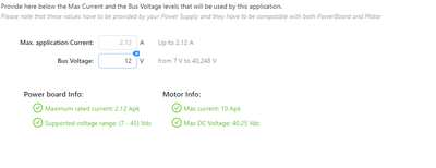

As per the datasheet this board can handle 7-45v, but my bus protection is set to 7-16v if I am trying to change it it's not allowing me. Kindly let me know how to work around this.
Best Regards
Jeffrey J
Try changing the json file Maximum rated voltage from 45 to 16.
maxRatedVoltage": 45
with
maxRatedVoltage": 16
and verify if it is reflected in your overvoltage protection.
The correct option is change in
section of MCSDK the value you require.
Hello @Jeffrey1,
In the X-NUCLEO-IHM16M1 single-shunt use case (note that the 3-shunt use case is not compatible with the NUCLEO-F446RE board), the R74 resistor must be added to connect MCU pin PA7.
The voltage limitation is determined by the maximum DC voltage setting of the motor.
Best regards.
GMA
 Hello @GMA
- so if my understanding is correct, I won't be able to do 6 PWM control using F446RE?
Or
- if I add R74 resistor then I'll be able to do 6 PWM control? (let me know what value of resistance)

Hello @Jeffrey1,
6 PWM control with single-shunt current sensing topology is available. Add a 0-ohm resistor to R74.
Use a DC supply that aligns with your motor specifications (12 V in this case).
