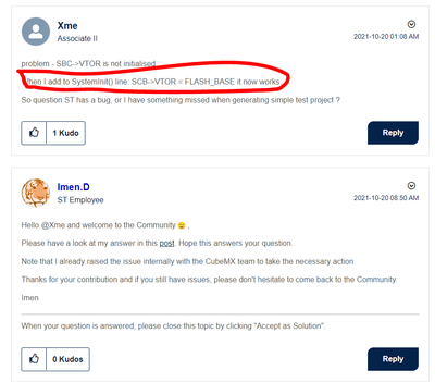

The solution provided by Xme helped. But to figure this out was a few days work for me. May be a permanent solution can be found.

Is this a custom board?
Is BOOT0 pulled LOW ?
Is there a boot loader at 0x08000000 and an app somewhere deeper in FLASH ?
Doesn't SCB->VTOR normally get set in SystemInit() ?

2024-01-20 1:04 PM - edited 2024-01-20 1:05 PM
Hi, I am getting similar problem in below setup:
1. Device is STM32U585.
2. ST provided BL is being used in the project.
3. This Project is TFM enabled.
4. Application is using threadX in non-secure zone.
My problem seems as same as below screenshot.
I have spent enough time on this and now got completely blank. Looking out for immediate support from #ST #STM32U5 #SysTick

2024-01-20 1:14 PM
>> Looking out for immediate support..
It is the weekend
The Vector Table is defined via SCB->VTOR, this address typically needs 512-byte alignment, depending on the number of vectors.
The table could be in RAM, you could change individual vectors that way.
The main vector list will be in startup.s make sure you have the name of the functions there, and that you get linkage. Watch C++ / .CPP name mangling if using those.
Watch SystemInit() configuration of SCB->VTOR if deeped in memory. A smarter method is to use linker symbols to assign the address based on the build settings.
If _disable_irq() is used in the loader, you'll need to re-enable
