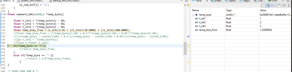

I am having some issues with precision of floating point calculations with STM32L431CBT6.
As one can see that when I do floating point calculation I am getting 1.23000002 instead of 1.23.
Can anyone suggest more efficient and accurate way to do this kind of calculation. I need very precise value for my application.

I think, convert_int() can be replace by atof(), with maybe byte[4] set to 0. Otherwise flot number have some small inaccuracy.

The C language has two types of floating-point number - float and double.
float uses 32-bits to represent a number and gives between 6 and 9 digits of precision.
double uses 64 bits and gives twice that.
So just use the word "double" where previously you used "float".

It is in the nature of Floating Point that you will get such errors
https://docs.oracle.com/cd/E19957-01/806-3568/ncg_goldberg.html
Have you considered working in (scaled) integers ... ?

@DKhan.1 but note that the Cortex-M4's floating-point hardware is only 'float' - so 'double' will be done in software...
Use doubles to carry more "precision", but be aware that the binary number space can be very unforgiving with certain numbers, as decimal can be with 1/3
People use different methods for financial / book-keeping for example.
If this is important truncate the numbers, or use integer methods to get the rounding/forms that you want / need.
1.23000002 is a more precise number than 1.23.
Or do you mean you want a number with no more than 2 decimal places?
