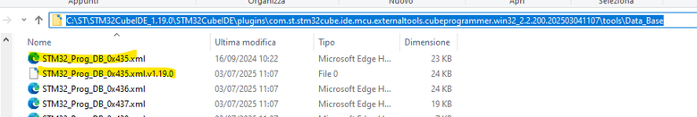

2025-09-09 4:30 AM
Hey Marti,
I'm using the same micro-controller and I had the same issue after updated to STM32CubeIDE v.1.19.0 and STM32CubeProgrammer v.2.20.0.
I'm still waiting answer from ST, however I temporarily solved using the DB file from the old STM32CubeIDE v.1.16.1 -see attachment-.
Rename the original and copy the attached file in this folder.
Hope it can solve.
Jaime R
